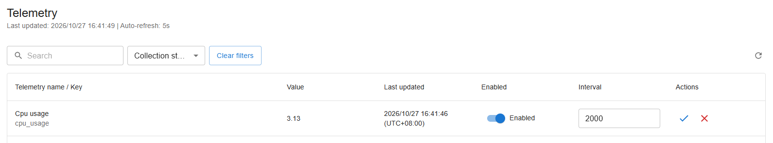

In WEDA Console: Select the intended Org, open Devices, select the device and inspect its Telemetry tab for received values. The tab can also turn a sensor's reporting on or off and change its reporting interval, as shown in Configure Data Reporting. Use the APIs below to discover settings, configure local recording and check apply results.

In WEDA Console, for the WEDA Node shown here: In its Telemetry tab, select the sensor row's edit icon, adjust Enabled and Interval, then use the checkmark to save or the cross to cancel. Follow the configuration and apply-result checks below to verify the requested behavior.
