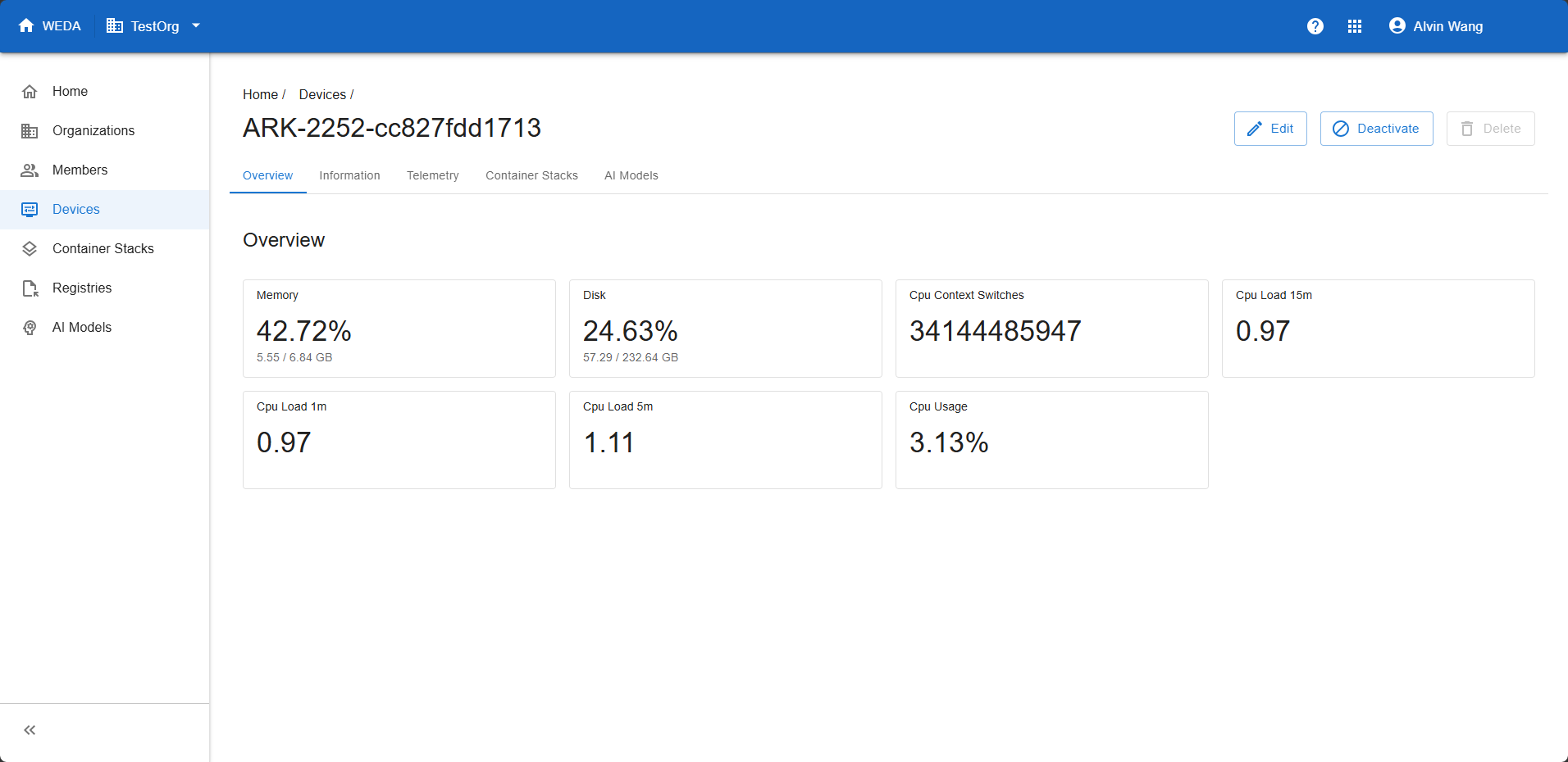

View Device Details and Connectivity

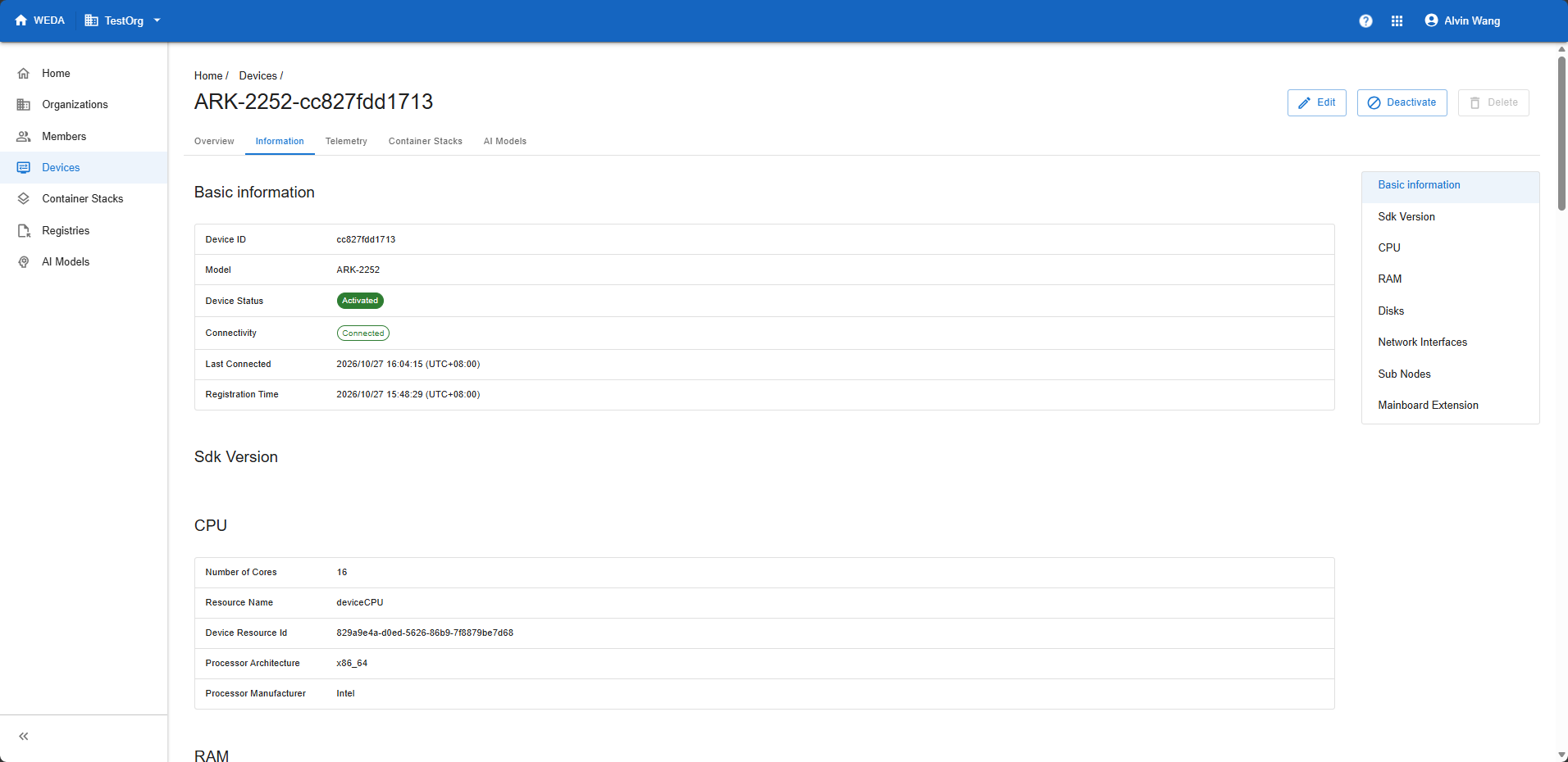

In WEDA Console: Open the WEDA Node's details and choose the view for your check:
- Overview: Review reported resource values, such as memory, disk and CPU metrics.
- Information: Check the Device ID, Model, lifecycle status and available hardware information. Inspect connectivity separately from lifecycle status.

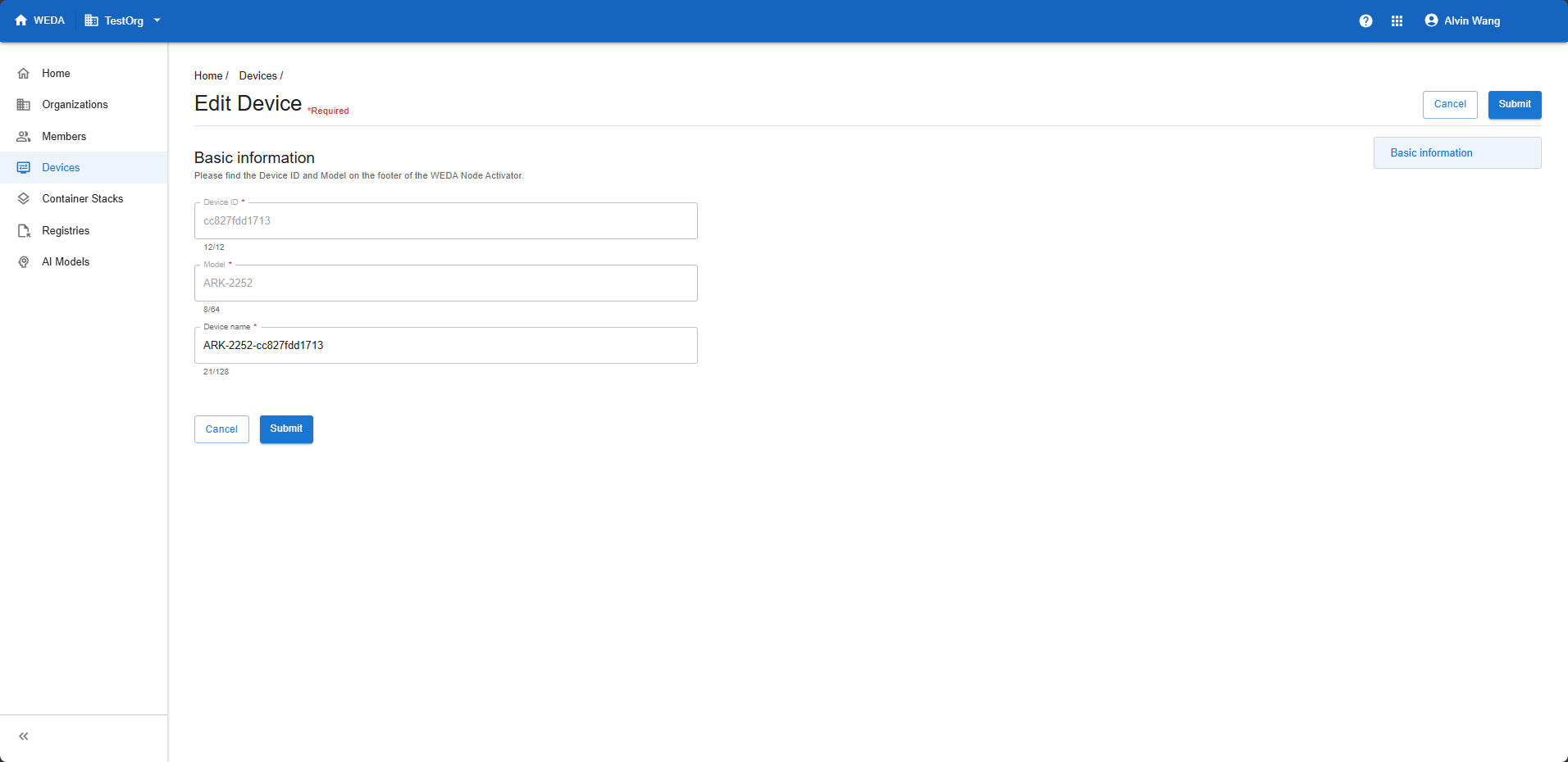

Update Device Information
The organization-scoped update changes the name of a WEDA Node or Custom Device. Confirm its current Org and ID before submitting the new name.

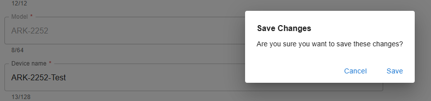

In WEDA Console, for the WEDA Node shown here:
- Open the device's details and select Edit.
- Change Device name. Device ID and Model are read-only in this form.
- Select Submit, then select Save in Save Changes.
- Read the device again and confirm the new name and unchanged Device ID.

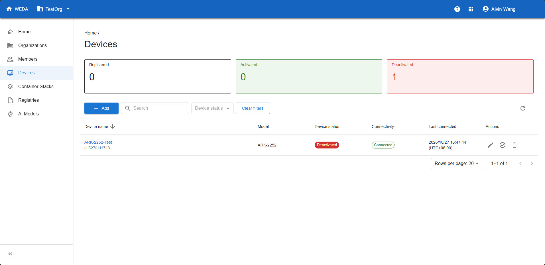

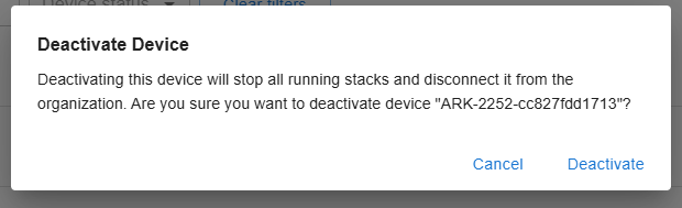

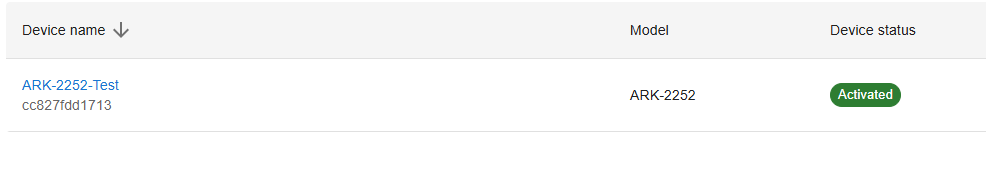

In WEDA Console, for a WEDA Node:
- Find the intended device in Devices, select Deactivate and review the confirmation.
- Confirm the action, then refresh the list and check Device status: Deactivated.

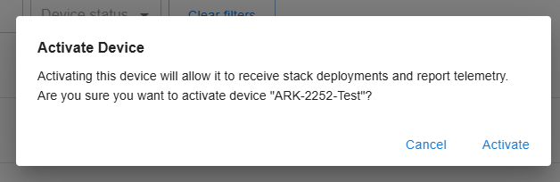

- To reconnect the device, select Activate, then confirm Activate Device.

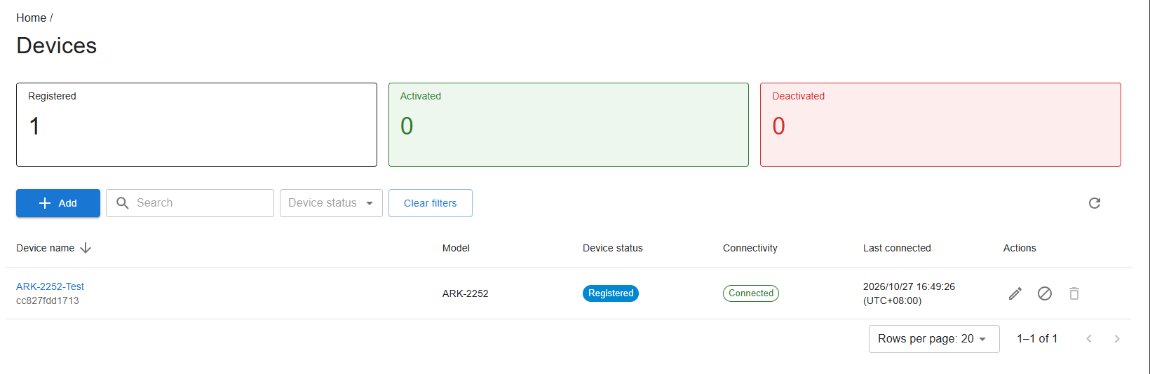

- Refresh the list. The device first returns to Registered; allow time for WEDA Node to activate again, then check for Activated.
After reactivating a WEDA Node, wait for Registered to become Activated before continuing with operations that require activation. Check the device's connection and received data separately. The Console's Connectivity label and the Device status column describe different checks.

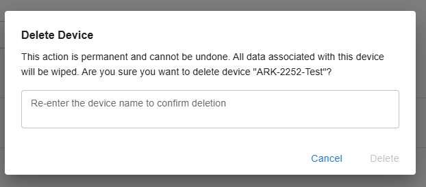

- Confirm that Device status is Deactivated and that you are an Admin of its Org. The Delete action is unavailable while the WEDA Node is Activated or Registered.
- Select Delete for the intended device.
- In Delete Device, re-enter its current device name, such as ARK-2252-Test, then select Delete.
- Refresh the device list and confirm that the same Device ID is no longer listed.
