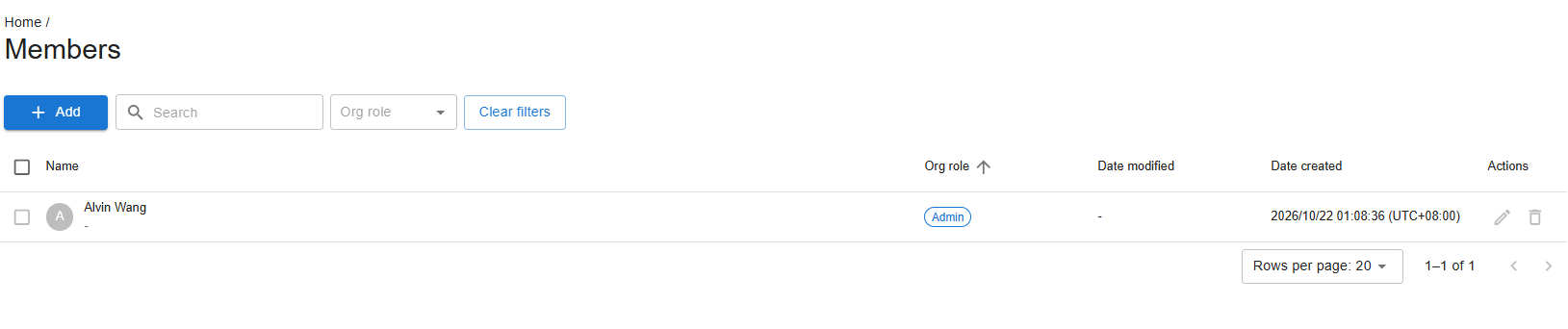

  1. Select the target organization in the top bar, then open Members. Check the selected Org and its existing members before adding anyone.
Members page for TestOrg showing one existing member with the Admin role and an Add button.
Confirm the target Org in the top bar before selecting Add.

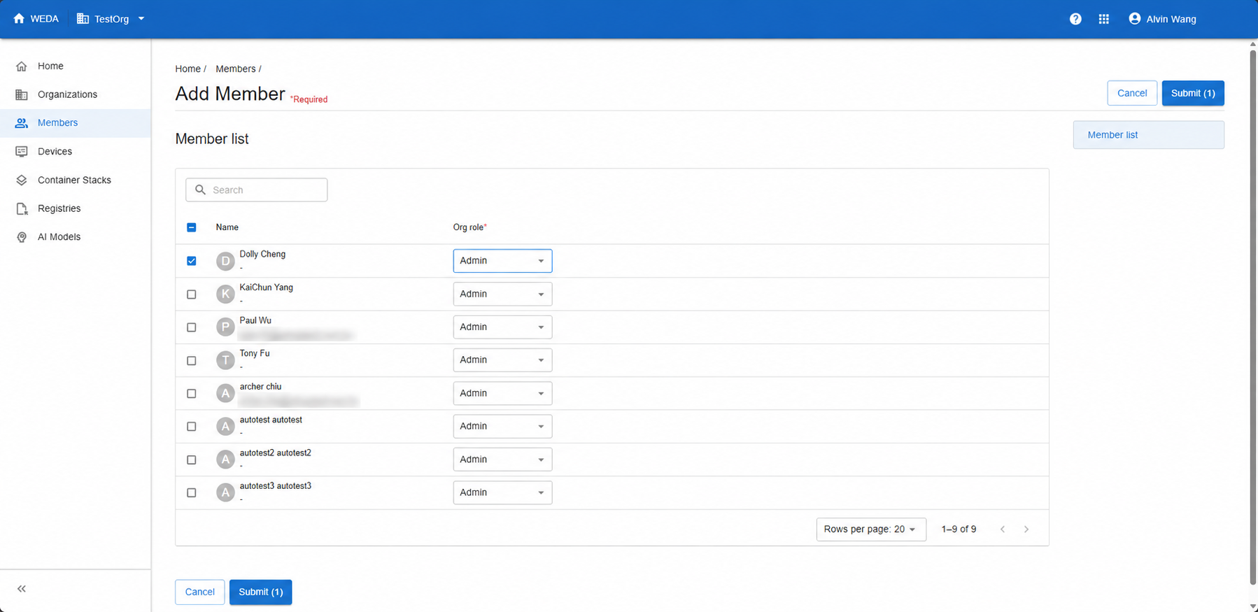

  1. Select Add. In Add Member, use Search to find the existing Tenant users you want to add.
  2. Select the checkbox beside each intended user and confirm Admin under Org role.
Add Member page with Dolly Cheng selected, Admin as the Org role and Submit (1) buttons; email addresses are blurred.
Dolly Cheng is selected with the Admin role. Submit (1) indicates one selected member.

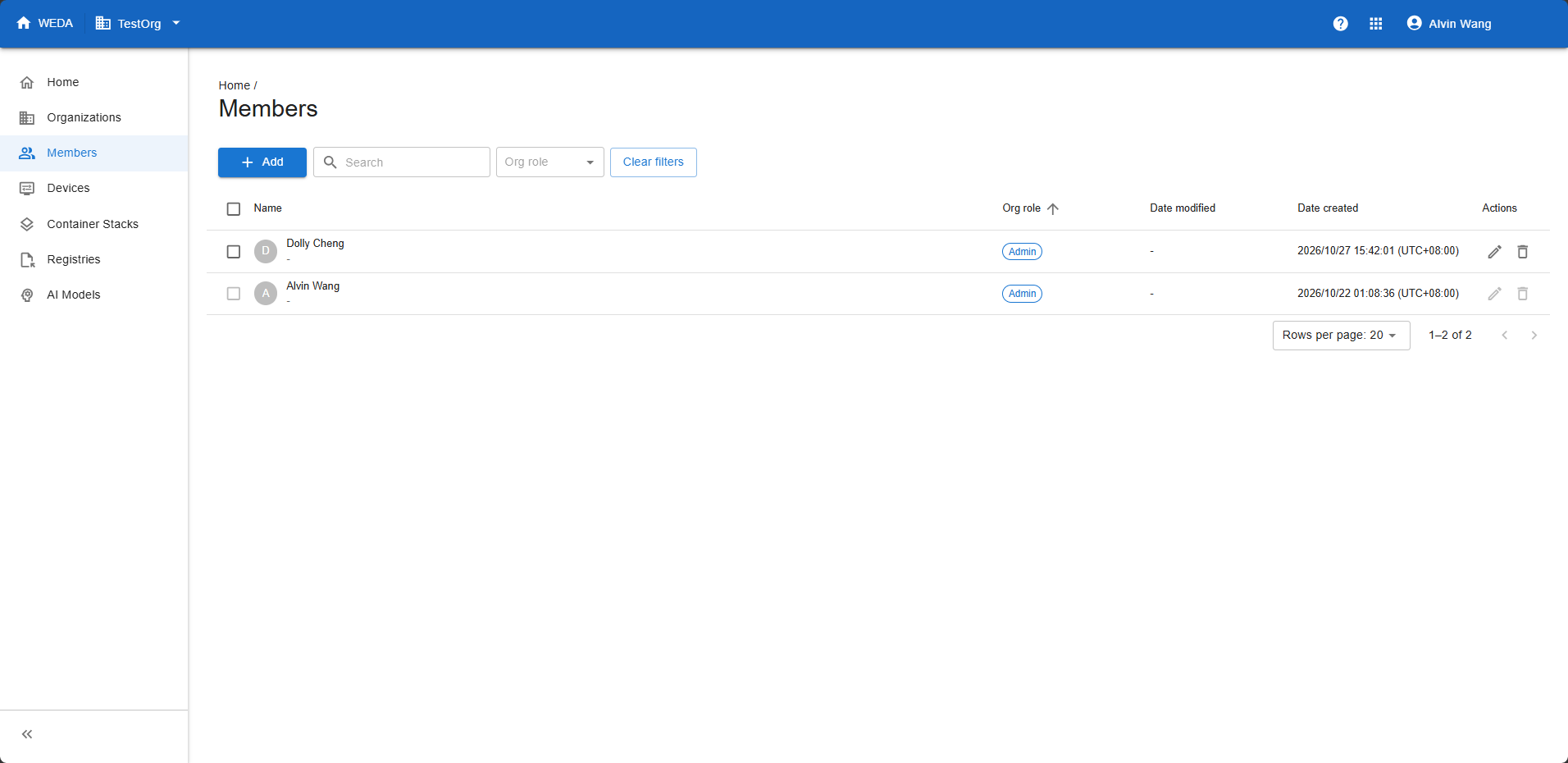

  1. Return to Members and confirm that each added user appears with the intended Org role.
Members page for TestOrg showing Dolly Cheng and the existing member, both with the Admin role.
The resulting list includes Dolly Cheng with the Admin role.
Check the result: The selected users are listed in the intended Org with Admin access.

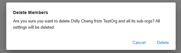

  2. Select the target member's trash icon under Actions.
  3. In Delete Members, check the member's name and the organization. The confirmation includes removal from that Org and all its sub-organizations.
Delete Members confirmation asking whether to delete Dolly Cheng from TestOrg and all its sub-organizations, with Cancel and Delete buttons.
The confirmation includes TestOrg and its sub-organizations. Review that scope before selecting Delete.
  1. Select Delete to confirm removal.

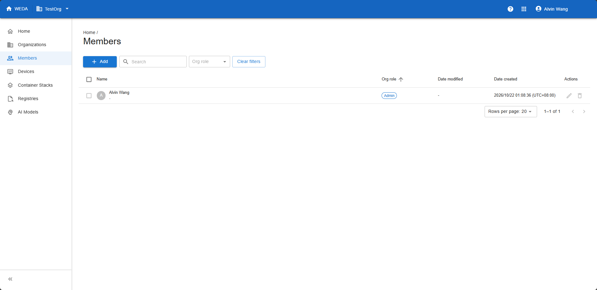

  2. Return to Members and verify that the target user is no longer listed and the remaining admin is still present.
Members list after removal showing only the remaining Admin member; Dolly Cheng is no longer listed.
The removed member no longer appears in the list.
Check the result: The target membership is removed from the intended Org. The person's Tenant account remains separate from this Org membership.
