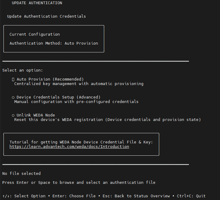

Choose the authentication method that matches the prepared file:
Authentication methodFile to use
Auto Provision (Recommended)A provisioning key supplied for your WEDA deployment.
Device Credentials Setup (Advanced)The device-specific credential file (.bin) downloaded above.
The screenshot below shows these choices under Manage WEDA Node > Update Authentication Credentials for an installed Node. During first-time setup, Use Local Credential File opens Authentication Configuration instead.
WEDA Node Activator Update Authentication screen with Auto Provision (Recommended), Device Credentials Setup (Advanced), and a file-selection prompt.
Update Authentication Credentials on an installed Node. Match the authentication method to the file prepared for your device or deployment.
