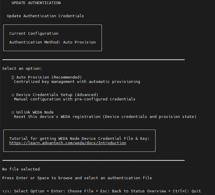

The screenshot below shows these choices under Manage WEDA Node > Update Authentication Credentials for an installed Node. During first-time setup, Use Local Credential File opens Authentication Configuration instead.
WEDA Node Activator Update Authentication screen with Auto Provision (Recommended), Device Credentials Setup (Advanced), and a file-selection prompt.
Update Authentication Credentials on an installed Node. Match the authentication method to the file prepared for your device or deployment.
  1. For first-time setup, select Use Local Credential File in the Activator's Credential Source.
  2. In Authentication Configuration, select Device Credentials Setup (Advanced) for the downloaded device credential. Use Auto Provision (Recommended) only when you have the provisioning key for that deployment; the two file types are not interchangeable.
  3. Select the .bin file in the file picker and press Enter. Press n after selection to continue to Review and Confirm.
