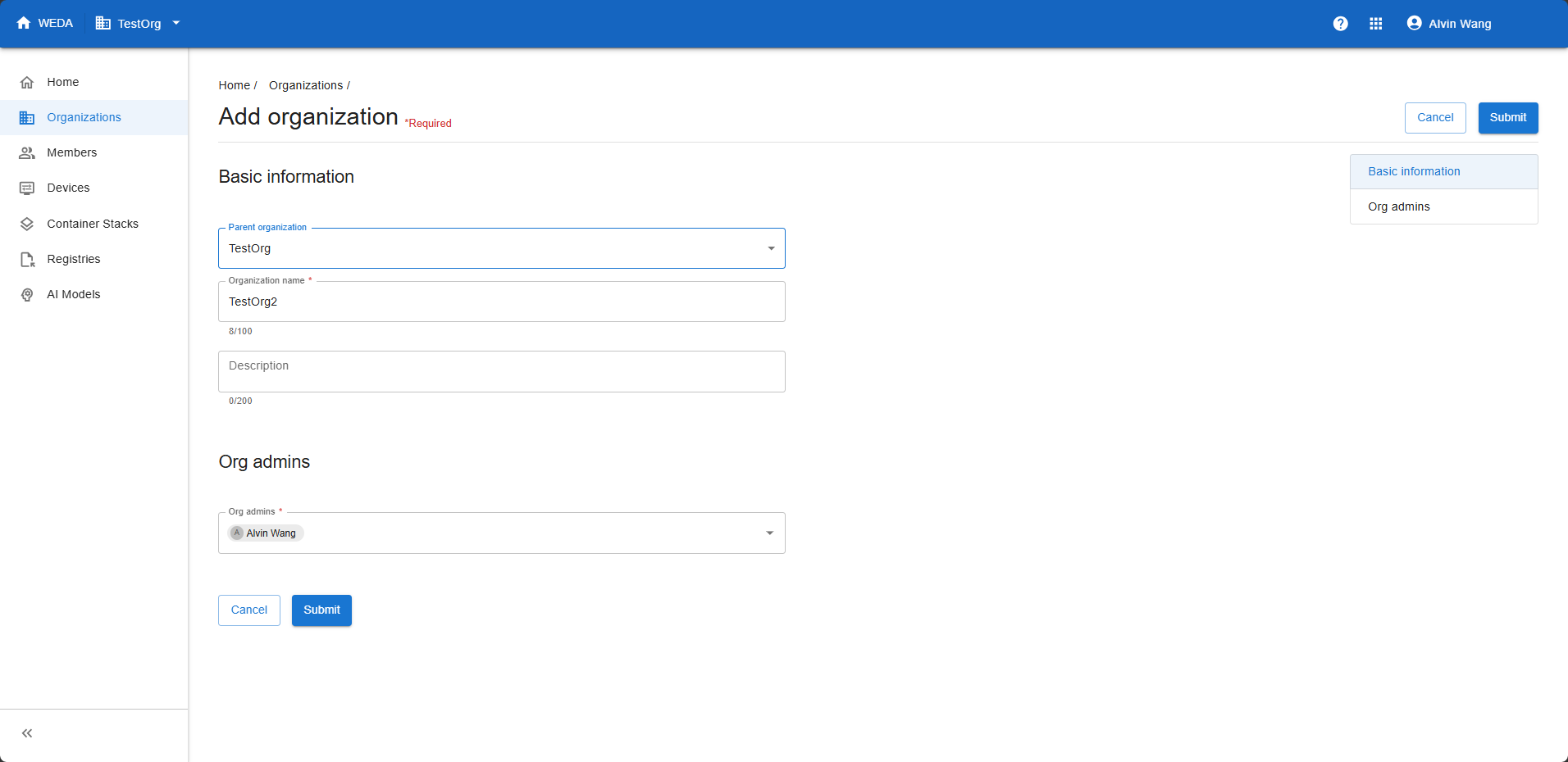

  1. Open Organizations and select Add.
  2. Complete Basic information:
    • Parent organization: Select the parent for a sub-organization. Leave it unset when creating a root organization.
    • Organization name: Enter the name, up to 100 characters.
    • Description: Optionally describe its purpose, up to 200 characters.
  3. In Org admins, assign at least one administrator.
Add organization form with TestOrg as the parent, TestOrg2 as the name, an empty Description and an assigned Org admin.
Create TestOrg2 under TestOrg and assign its Org admins before submitting.

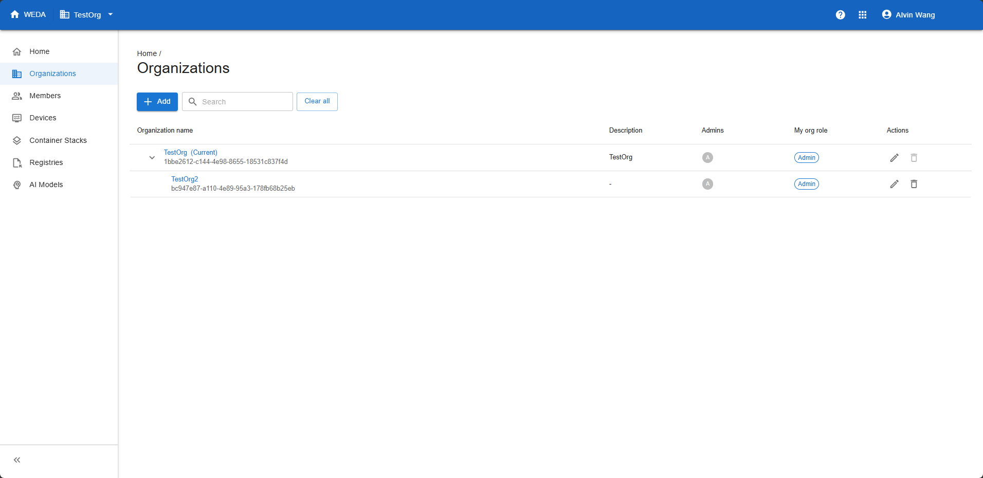

View Organizations and Hierarchy​
In WEDA Console:
  1. Open Organizations and search for the organization you need.
  2. Expand the arrow beside a parent to view its child organizations. Check the name, description, administrator information and My org role.
Organizations list showing TestOrg marked Current, TestOrg2 beneath it, and Admin roles for both organizations.
TestOrg2 is listed beneath TestOrg. The Current marker identifies the selected organization.

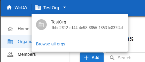

  1. Open the organization menu in the top bar and select Browse all orgs.
Top-bar TestOrg menu showing the current organization and Browse all orgs.
Browse all orgs opens the organization selector.

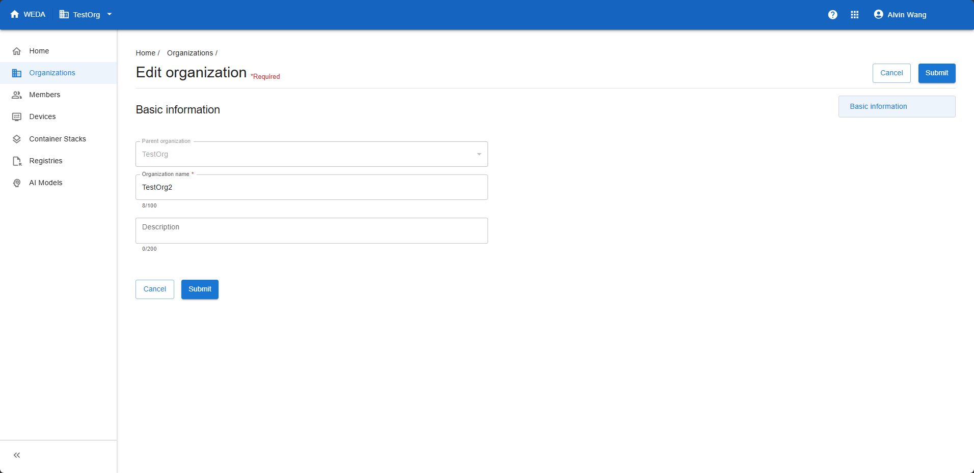

In WEDA Console:
  1. Open Organizations, find the target organization and select its pencil icon under Actions.
  2. In Edit organization, change Organization name or Description. Parent organization is read-only.
Edit organization form for TestOrg2, with TestOrg as a disabled parent field, editable name and description, and Submit buttons.
Edit the organization's name or description. Its parent cannot be changed here.

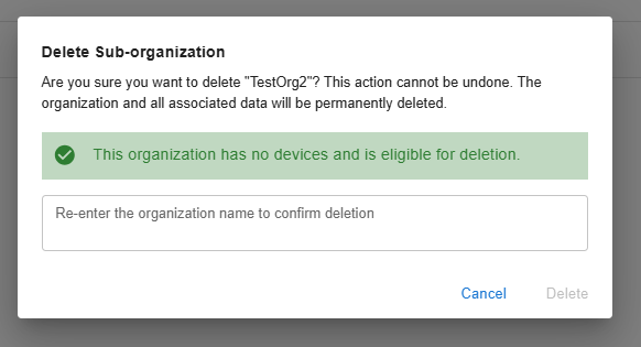

  1. Open Organizations, find the intended child organization and select its trash icon under Actions.
  2. In Delete Sub-organization, check the displayed organization name and deletion eligibility message.
Delete Sub-organization dialog for TestOrg2, showing a no-devices eligibility message, a field to re-enter the organization name, and a disabled Delete button while the field is empty.
Check the target and eligibility message, then re-enter the organization name before confirming deletion.
  1. Re-enter the target organization's name in the confirmation field, then select Delete to confirm permanent deletion.
