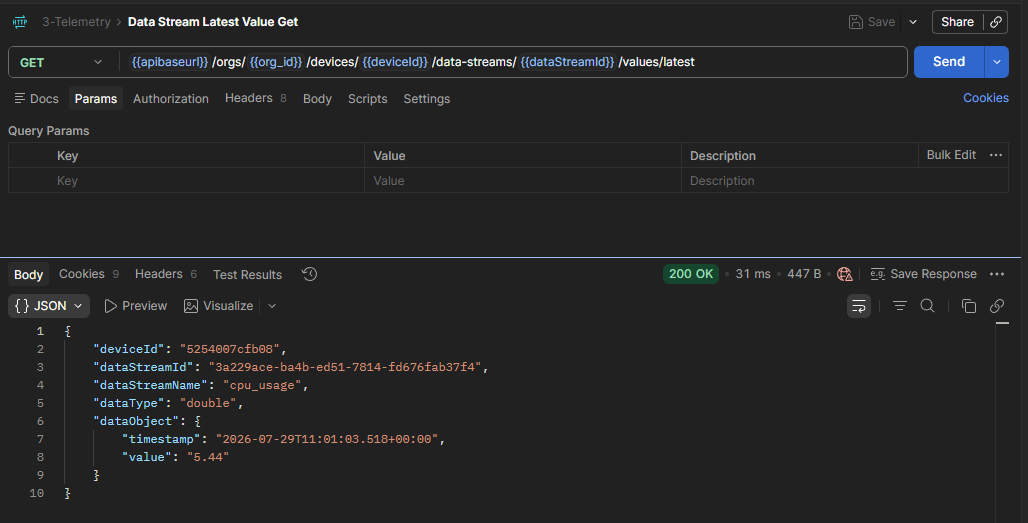

6. Get Device Telemetry Data​
Once the WEDA Node client daemon is running and authorized, telemetric updates automatically flow from WEDA Node to WEDA Core.
Postman Collection: 3-Telemetry​
Each sensor the device reports becomes one DataStream. Reading a value is two requests: list the device's DataStreams to find the one you want, then query that DataStream's latest value.

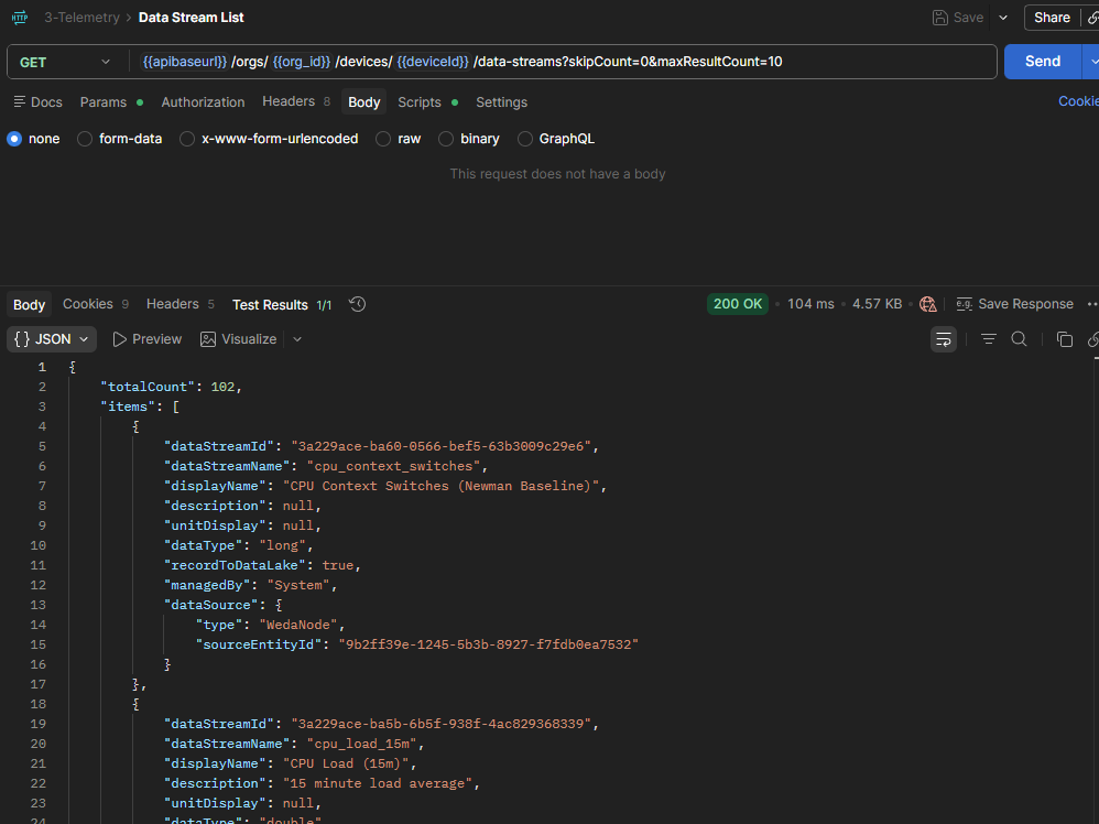

Step 1: List the device's DataStreams​
  • Data Stream List
    • Method: GET
    • URL: {{apibaseurl}}/orgs/{{org_id}}/devices/{{deviceId}}/data-streams?skipCount=0&maxResultCount=10
    • Description: Returns every DataStream on the device, covering both system status and onboard sensor measurements, with the dataStreamId you need for the next request.
    • Expected result: WEDA Core returns 200 with totalCount and a paged items array. A typical WEDA Node reports around a hundred DataStreams, so raise maxResultCount or page through with skipCount to see them all.
postman list data streams
Example Response
"totalCount": 102,
"items": [
"dataStreamId": "3a229ace-ba60-0566-bef5-63b3009c29e6",
"dataStreamName": "cpu_context_switches",
"displayName": "CPU Context Switches",
"description": null,
"unitDisplay": null,
"dataType": "long",
"recordToDataLake": true,
"managedBy": "System",
"dataSource": {
"type": "WedaNode",
"sourceEntityId": "9b2ff39e-1245-5b3b-8927-f7fdb0ea7532"
"dataStreamId": "3a229ace-ba5b-6b5f-938f-4ac829368339",
"dataStreamName": "cpu_load_15m",
