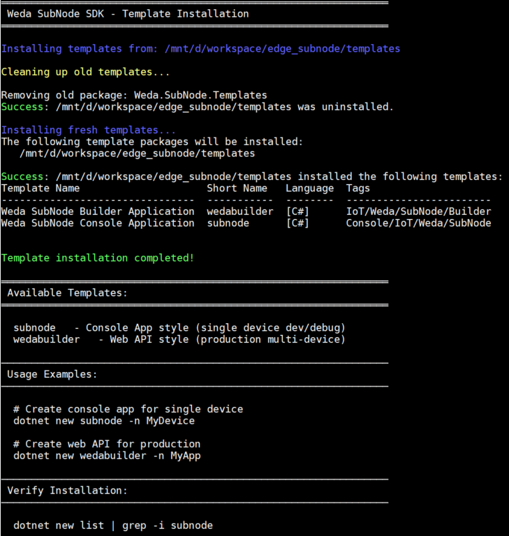

STEP 1: Install Sub Node SDK Templates​
There are two ways to install templates:
Navigate to the SDK repository root and run:
bash scripts/install-templates.sh
Expected output:
WEDA SubNode Install Script
2. Manual Installation​
If the script fails, each template can be installed manually:
cd /path/to/edge_subnode/templates
# Install subnode template
dotnet new install ./subnode
# Install wedabuilder template
dotnet new install ./wedabuilder
Verify Installation​
Check that all templates are installed:
dotnet new list | grep -i subnode
Expected output:
Template Name                         Short Name   Language  Tags
Weda SubNode Console Application subnode [C#] Console/IoT/Weda/SubNode
Weda SubNode Web API Application wedabuilder [C#] Web/WebAPI/IoT/Weda/SubNode
If you see both templates listed, installation was successful! ✅

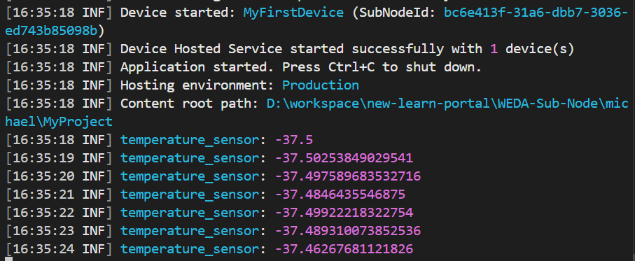

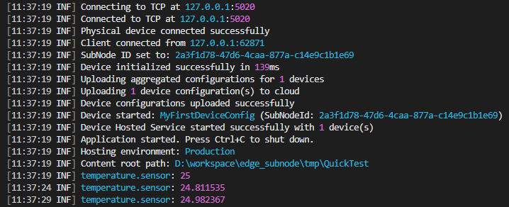

Quick Test​
You can execute the template project on a built-in simulator, allowing local development and testing without physical devices.
The simulator emulates device data and interactions, enabling you to validate API endpoints and integration logic before deploying to real hardware.
If you want to test the simpler API template:
cd MyFirstApi
dotnet run
Expected output:
Template Wedabuilder quick test
🎉 If the log continuously outputs temperature measurements, it indicates that the template project is running successfully and the device integration is functioning as expected.
Advanced: Transform​
Transform is the first processing stage in the Data Pipeline, responsible for performing numerical transformations on raw sensor values. SubNode includes three built-in transforms: linear/curve calibration, unit conversion, and large data chunking. Each transform can be configured via JSON or code and supports dynamic parameter updates from the cloud. Find out for more details at SubNode Github. Here is an example of how to configure a linear calibration transform for a temperature sensor:
1. devicecfg.json​
"SubNode": {
"Name": "MyModbusDevice",
"SubNodeType": "AdamEthernet",
"Manufacturer": "Advantech",
"Model": "Demo",
"SwVersion": "1.0.0"
"DeviceConfigs": {
"MyFirstDevice": {
"Enabled": true,
"DeviceCommunication": {
"Host": "127.0.0.1",
"Port": 5020
"Dtdl": {
"AutoGenEnabled": true
"Properties": {
"SlaveId": 1
"Sensors": [
"Name": "temperature_sensor",
"SensorGroup": "TEMP",
"SensorInfo": {
"DisplayName": "Temperature Sensor",
"Description": "Main temperature reading",
"Schema": "double"
"Parameters": {
"RegisterType": "HoldingRegister",
"RegisterAddress": 0,
"RegisterCount": 2,
"DataType": "Float32"
"Report": {
"Enabled": true,
"Interval": 1000,
"Unit": "celsius",
// add transform configuration
"TransformPipeline": [
"Type": "calibration",
"Parameters": {
"Scale": 0.1,
"Offset": -40
2. Run the application​

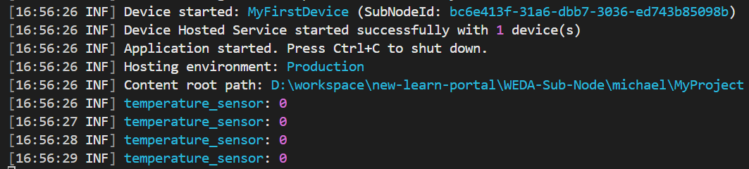

Advanced: DspFilter​
DSP (Digital Signal Processing) Filter is the second processing stage in the Data Pipeline, executed after Transform. Unlike Transform, DSP Filters are typically stateful—they retain historical data to compute results (for example, a moving average requires previous values). SubNode includes three built-in DSP Filters, each maintaining independent state per sensor. Find out for more details at SubNode Github. Here is an example of ReluFilter configuration:
1. devicecfg.json​
"SubNode": {
"Model": "Demo",
"DeviceConfigs": {
"MyFirstDevice": {
"Enabled": true,
"Port": 5020
"Dtdl": {
"Properties": {
"SlaveId": 1
"Sensors": [
"SensorInfo": {
"Schema": "double"
"Parameters": {
"RegisterCount": 2,
"Report": {
"Enabled": true,
"Interval": 1000,
"Unit": "celsius",
"Parameters": {
"Scale": 0.1,
"Offset": -40
// add DSP filter configuration
"DspPipeline": [
"Type": "relu",
"Enabled": true,
"Parameters": {}
dotnet run
Expected output:
subnode DSP

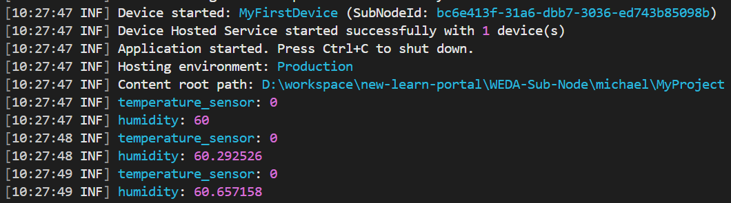

Advanced: Add a new sensor​
This tutorial demonstrates how to extend the WEDA Sub-Node framework by adding a humidity sensor. You will learn how to configure a new device, register it in the application, and simulate sensor data for testing purposes.
1. devicecfg.json​
Add a humidity device configuration to the devicecfg.json file.
Editing content: devicecfg.json
"SubNode": {
"Model": "Demo",
"DeviceConfigs": {
"MyFirstDevice": {
"Enabled": true,
"Port": 5020
"Dtdl": {
"Properties": {
"SlaveId": 1
"Sensors": [
"SensorInfo": {
"Schema": "double"
"Parameters": {
"RegisterCount": 2,
"Report": {
"Enabled": true,
"Interval": 1000,
"Unit": "celsius",
"Parameters": {
"Scale": 0.1,
"Offset": -40
"DspPipeline": [
"Type": "relu",
"Enabled": true,
"Parameters": {}
// Add a new sensor configuration for humidity
"Name": "humidity",
"SensorGroup": "AI",
"Parameters": {
"RegisterAddress": 2,
"RegisterCount": 2,
2. appsettings.json configure simulator​
Editing content: appsettings.json
"Serilog": {
"MinimumLevel": {
"Default": "Information",
"Override": {
"Microsoft": "Warning",
"System": "Warning",
"Microsoft.Hosting.Lifetime": "Information"
"WriteTo": [
"Name": "Console",
"Args": {
"outputTemplate": "[{Timestamp:HH:mm:ss} {Level:u3}] {Message:lj}{NewLine}{Exception}"
"TcpModbusSimulatorConfiguration": {
"TcpConnection": {
"IpAddress": "127.0.0.1",
"Port": 5020
"ModbusProtocol": {
"SlaveId": 1,
"UseModbusAddressing": false,
"HoldingRegisterBase": 0
"Simulation": {
"GlobalUpdateIntervalSeconds": 1,
"EnableValueChanges": true
"Sensors": [
"Name": "TemperatureSensor",
"Type": "Temperature",
"StartAddress": 0,
"RegisterCount": 2,
"DataType": "Float32",
"SimulationParams": {
"MinValue": 18.0,
"MaxValue": 32.0,
"InitialValue": 25.0,
"ChangeRate": 0.2,
"NoiseLevel": 0.1
"Name": "HumiditySensor",
"Type": "Humidity",
"StartAddress": 2,
"RegisterCount": 2,
"MinValue": 40.0,
"MaxValue": 80.0,
"InitialValue": 60.0,
"ChangeRate": 0.5,
"NoiseLevel": 0.2
3. Run the application​
dotnet run
Expected output:
Add a new sensor
