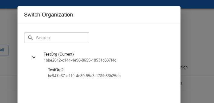

Choose the path that matches your environment:
  • Existing organization: Open the organization menu in the top bar, select Browse all orgs, then choose the organization in Switch Organization.
  • New organization: Follow the steps below to create one.
Switch Organization dialog showing TestOrg marked Current and its child TestOrg2.
Choose the organization in which you will register the device, then confirm its name in the top bar.

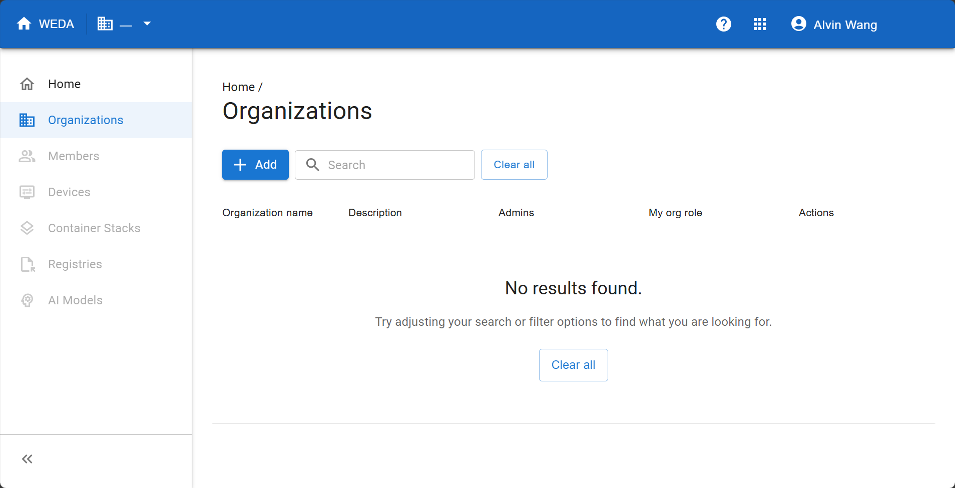

WEDA Console Organizations list with Add and Search controls and no results displayed.
Open Organizations and select Add to create your organization.

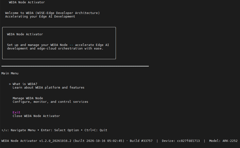

WEDA Node Activator displays the identity of your physical device. You need its Device ID and Model to create the matching device record in WEDA Console.
If the Activator is not installed, see WEDA Node Activator Installer before continuing.
Launch the Activator from its desktop shortcut, or run:
sudo /opt/Advantech/dmagent/weda-node-activator/bin/weda-node-activator
Copy the Device ID (labelled Device) and Model shown in the footer.
WEDA Node Activator main menu with Device cc827fdd1713 and Model ARK-2252 in the footer.
The footer shows Device: cc827fdd1713 and Model: ARK-2252 in this example. Copy the values shown on your own device.
Check the result: You have the Device ID and Model needed for Console registration.
Keep the Activator available. Complete the Console registration in step 3 before starting the Node setup wizard.

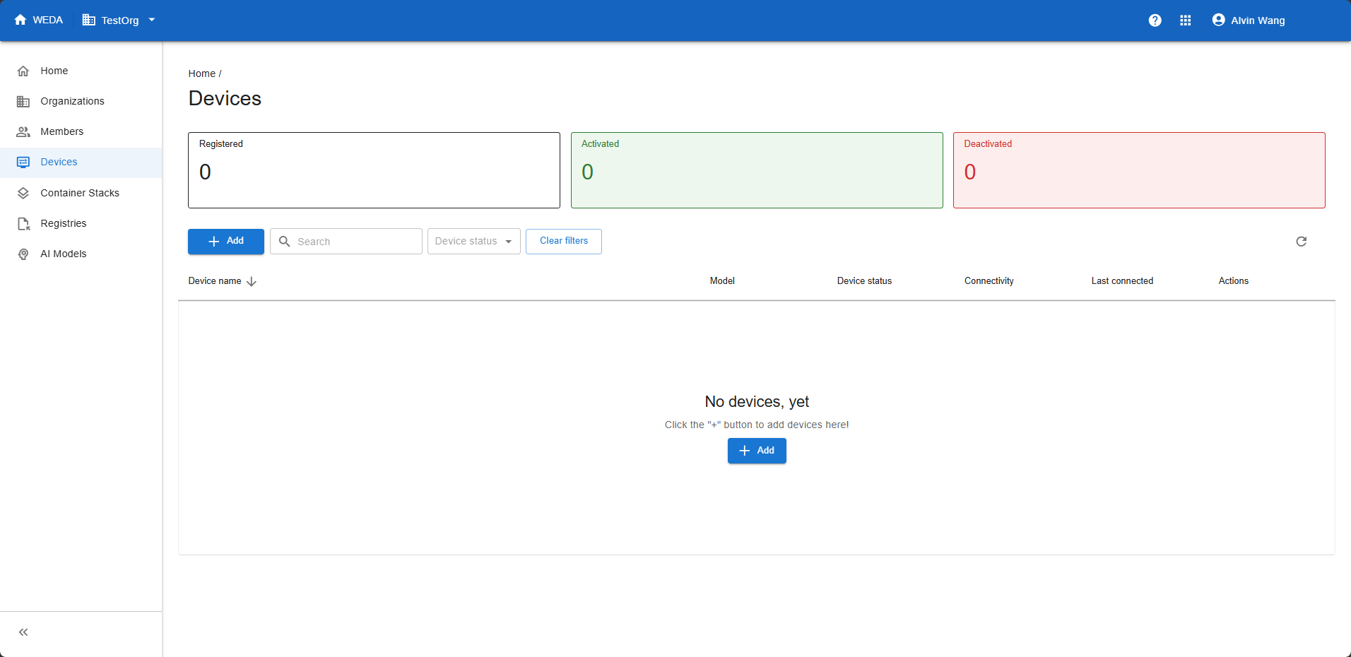

  1. In WEDA Console, check the selected organization, then open Devices.
Devices list in TestOrg with no devices registered and the Add control available.
Confirm the selected organization, then select Add in Devices.

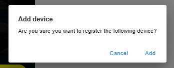

  1. Select Submit, then Add in the confirmation dialog.
Add device confirmation dialog with Cancel and Add buttons.
Select Add to confirm device registration.

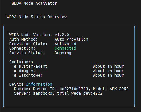

  6. In Service Status Overview, check the status after setup:
    • Provision State: Activated
    • Connection: Connected
    • Service Status: Running
WEDA Node Activator showing version v1.2.0, Provision State Activated, Connection Connected and Service Status Running for cc827fdd1713.
For the same demo device, the Activator reports Activated, Connected and Running.
Check the result: The Activator shows that WEDA Node is activated, connected and running.

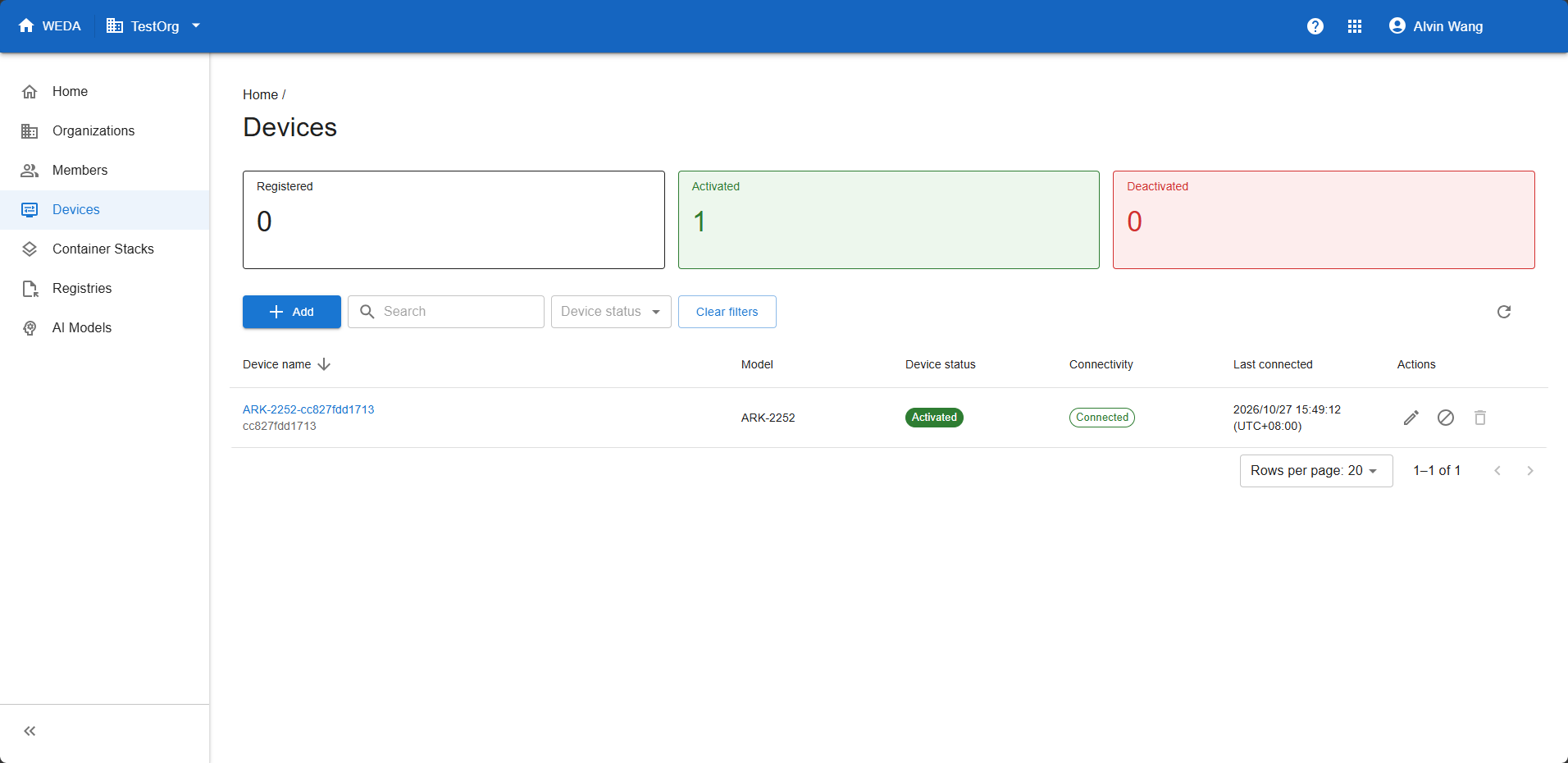

  1. Return to Devices in WEDA Console and locate the device under the intended organization.
  2. Allow a few seconds for the status to update, then refresh the list. Confirm that its activation and connection indicators show Activated and Connected.
TestOrg Devices list showing ARK-2252-cc827fdd1713 as Activated and Connected.
After WEDA Node activates and connects, refresh the list to check the same device record.
