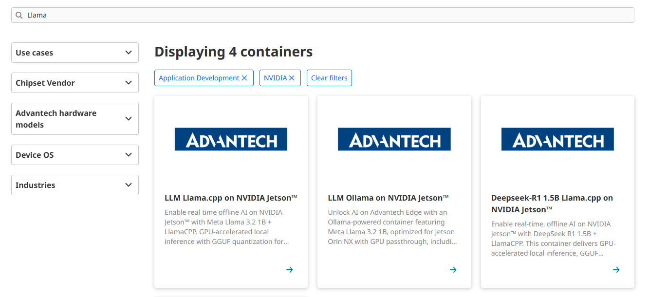

Step 2: Select a Container
Use the search bar with keywords or the category filters on the left side to find a container that matches your use case.
ACC Catalog Filter Example
Example: We'll use "LLM Ollama on NVIDIA Jetson™" as a reference throughout this guide.
