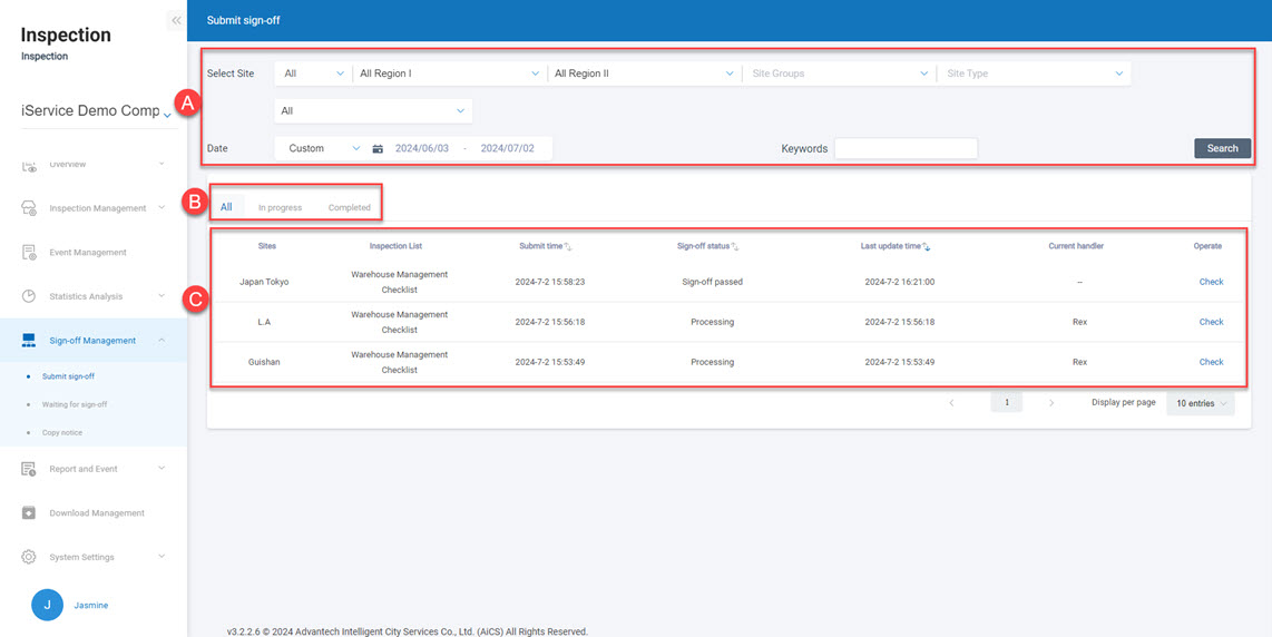

Submit sign-off​
Submitting a sign-off is a function in the sign-off process where, after completing an inspection, the inspector submits the generated inspection report to the next step or the final approver. This function ensures that the sign-off process follows the established workflow, and once submitted, relevant personnel will be notified to proceed. It helps improve process efficiency and ensures that all steps are completed on time.
Sign-Off Management_Submit sign-off_60%.jpg A. Options of sites/inspection checklist: select the sites by country, region, site type/group and site name. You can also perform conditional searches according to the inspection tables. B. Sign-off Progress: The sign-off progress is categorized, and you can click on different tabs to view inspection reports that are either in the process of being signed off or have been completed. C. Sign-off Information List: After selecting the sign-off progress category tab, detailed sign-off information will be listed. Click "View" to check the sign-off status of each sign-off node.

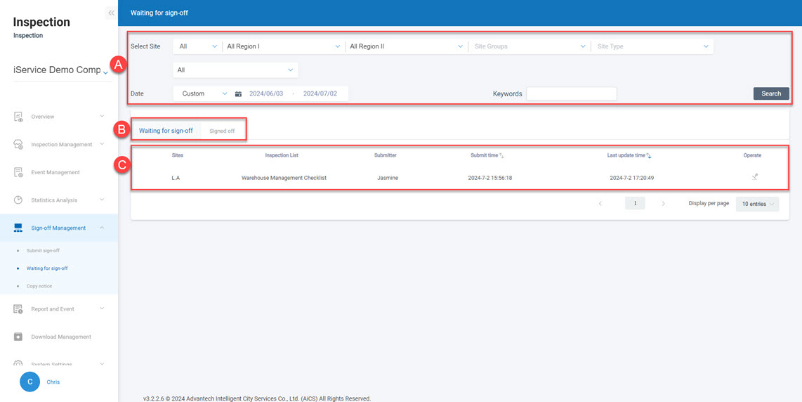

Waiting for sign-off​
The "Pending Sign-off" feature refers to inspection reports that are currently awaiting approval or confirmation in the sign-off process. Users can view reports, or tasks that require their sign-off on this page and proceed with the necessary review or approval actions. This feature helps ensure transparency in the sign-off process and keeps track of progress, preventing delays or omissions.

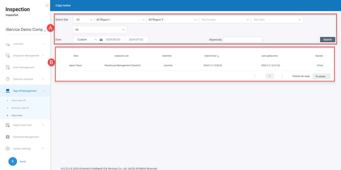

Copy notice​
In the sign-off process, when the sign-off is completed, the system can automatically send a copy of the notification to designated individuals. This feature ensures that relevant personnel are informed of the sign-off result promptly, without the need for manual notifications, helping to improve communication efficiency and maintain transparency in the process.

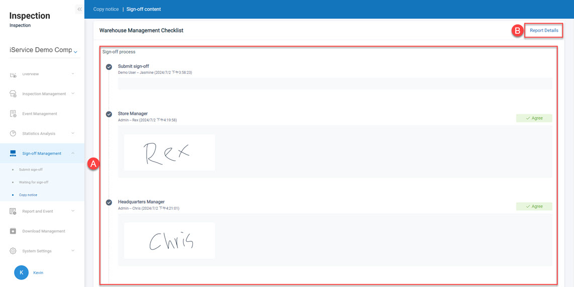

A. Time/job function options: adjusts the time interval, and the job or specific personnel of the data to search. B. Export in Excel format: the data on site inspection record could be exported as an Excel file. Sign-Off Management_Copy notice_CheckDetails_60%.jpg

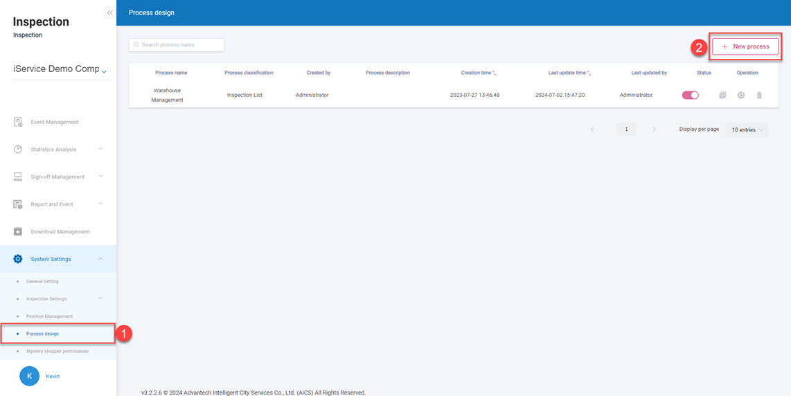

System Settings_Process Design_1_60%.jpg 1: Navigate to the 'System Settings' -> 'Process design' 2: Click on the '+ New process'

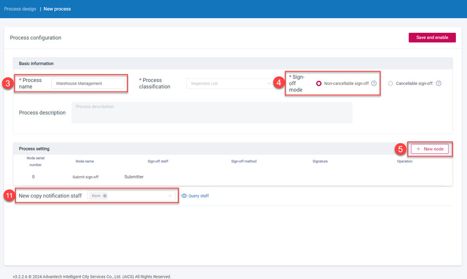

System Settings_Process Design_2_60%.jpg 3: Giving a name for this new process 4: In 'Sign-off mode', choose 'Non-cancellable sign-off' 5: Click on '+ New node' to add the approval node, it will take you to the 'Set node' settings page Plaese go to the next picture to see step 6
11: Choose a new copy notification staff member to receive all approval node completion notifications, in this sample, choose 'Kevin'

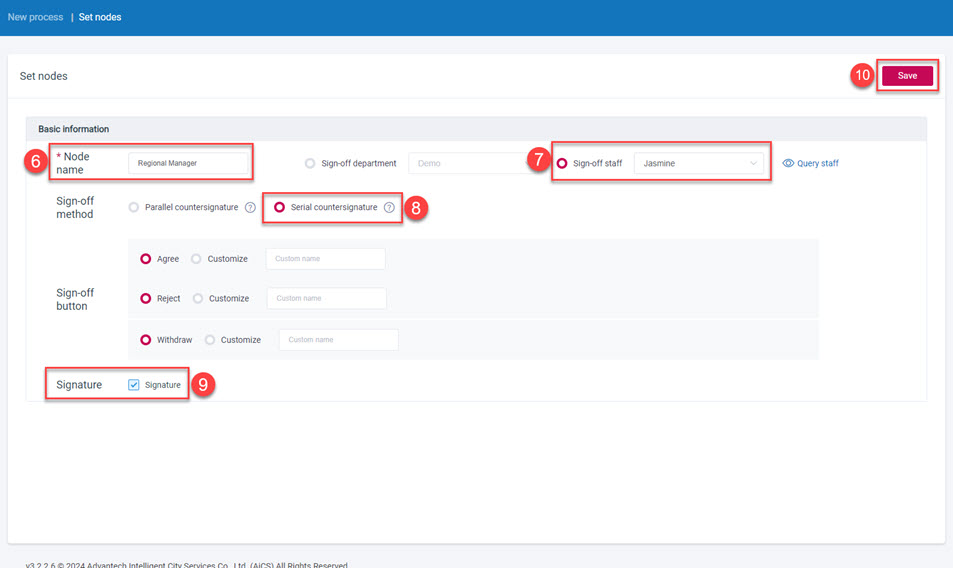

System Settings_Process Design_3_60%.jpg 6: Give a name to this node, in this node, enter 'Regional Manager' 7: Choose a memebr for the Sign-off staff, in this node, choose 'Jasmine' 8: In the Sign-off method, choose 'Serial countersignature' 9: Tick the 'signature' checkbox, This means the approver need to sign after completing the approval 10: Click the 'Save' button to apply the settings Please go to the previous picture to see step 11

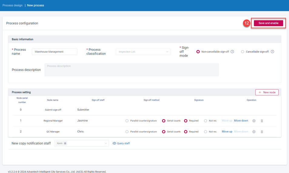

System Settings_Process Design_4_60%.jpg 12: Click the 'Save and enable' button to finish creating a new process design

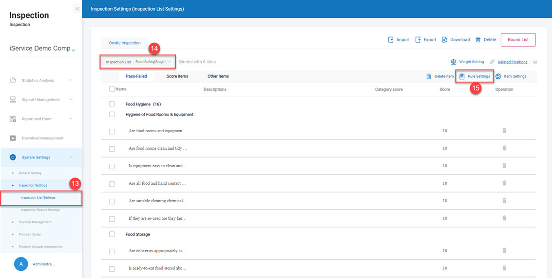

System Settings_Process Design_5_60%.jpg 13: Navigate to the 'Inspection Settings' -> 'Inspection List Settings' 14: Choose an inspection form that will use the sing-off process 15: Click on 'Ruls Settings' to enter the settings page

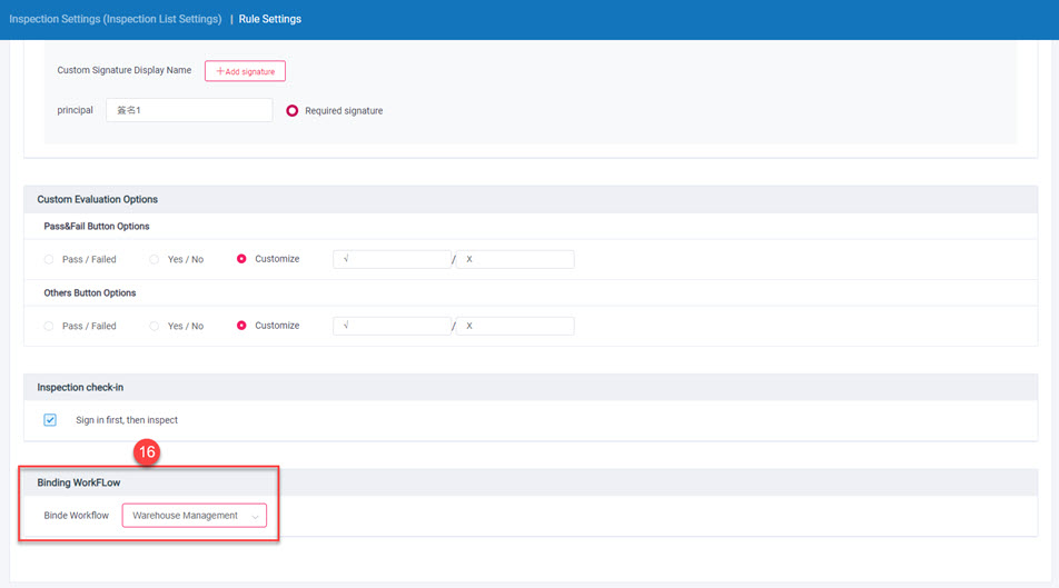

System Settings_Process Design_6_60%.jpg 16: In 'Binding WorkFlow', choose the sign-off process that will be used, and then click on the 'Save' button to apply the settings

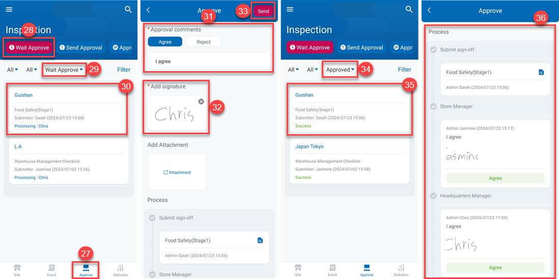

Approval node 2, Chris, logs into the inspection app Approval_2.jpg 27: Tap 'Approval' 28: Tap 'Wait Approval' 29: Select 'Wait Approval' 30: Tap here to enter the approval page 31: Tap the 'Agree' option and enter some notes 32: Sign here 33: Tap on the 'Send' button to apply settings 34: Select 'Approved' 35: List all approved sign-off processes, and then click on one 36: It will display the details of all approval nodes

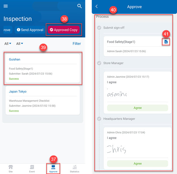

Copy Notification Receiver, Kevin, logs into the inspection app Approval_2_40%.jpg 37: Tap 'Approval' 38: Tap 'Approved Copy' 39: List all received notifications of signed-off copies 40: Tap notification to view the approval details 41: Tap the 'view report' icon to view the details of inspection report
