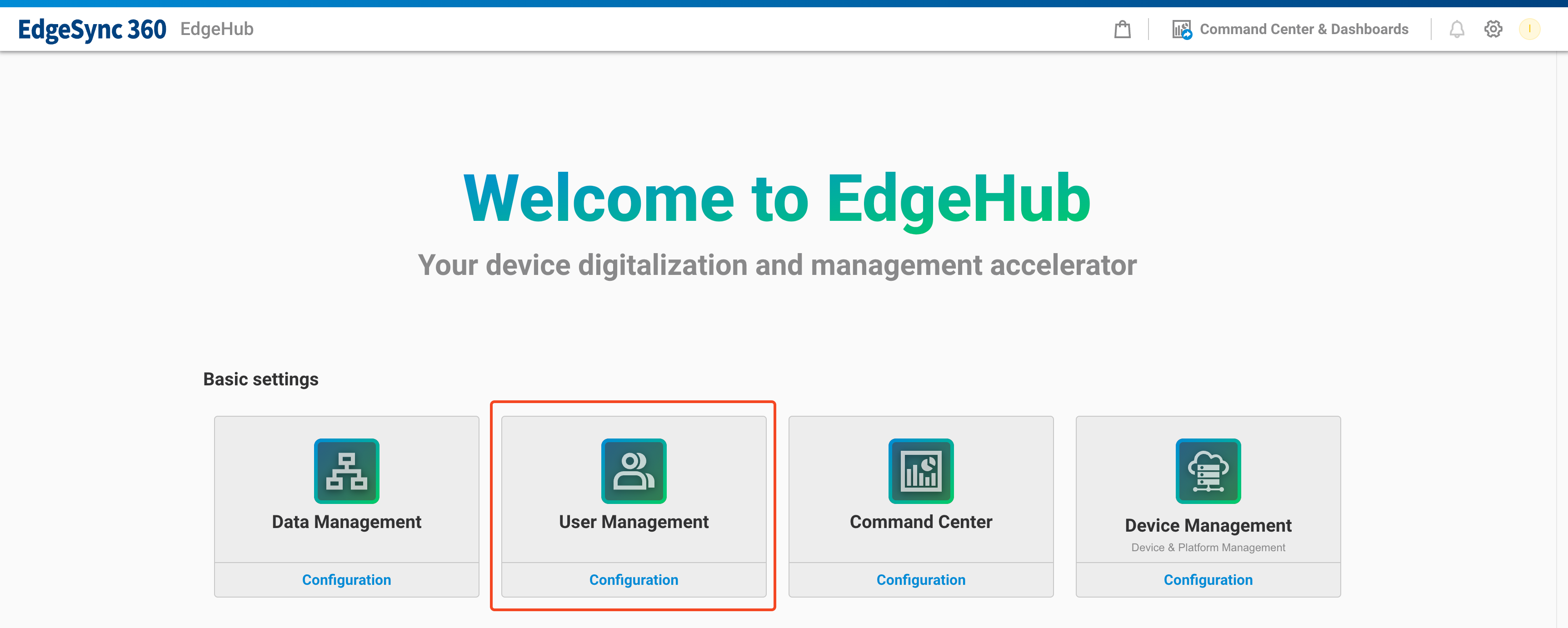

  1. A user with Tenant Admin permissions enters their own tenant and goes to User management. login-dashboard-01-user-management-new.png

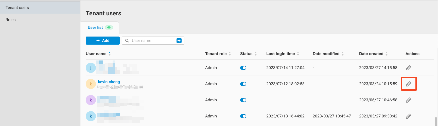

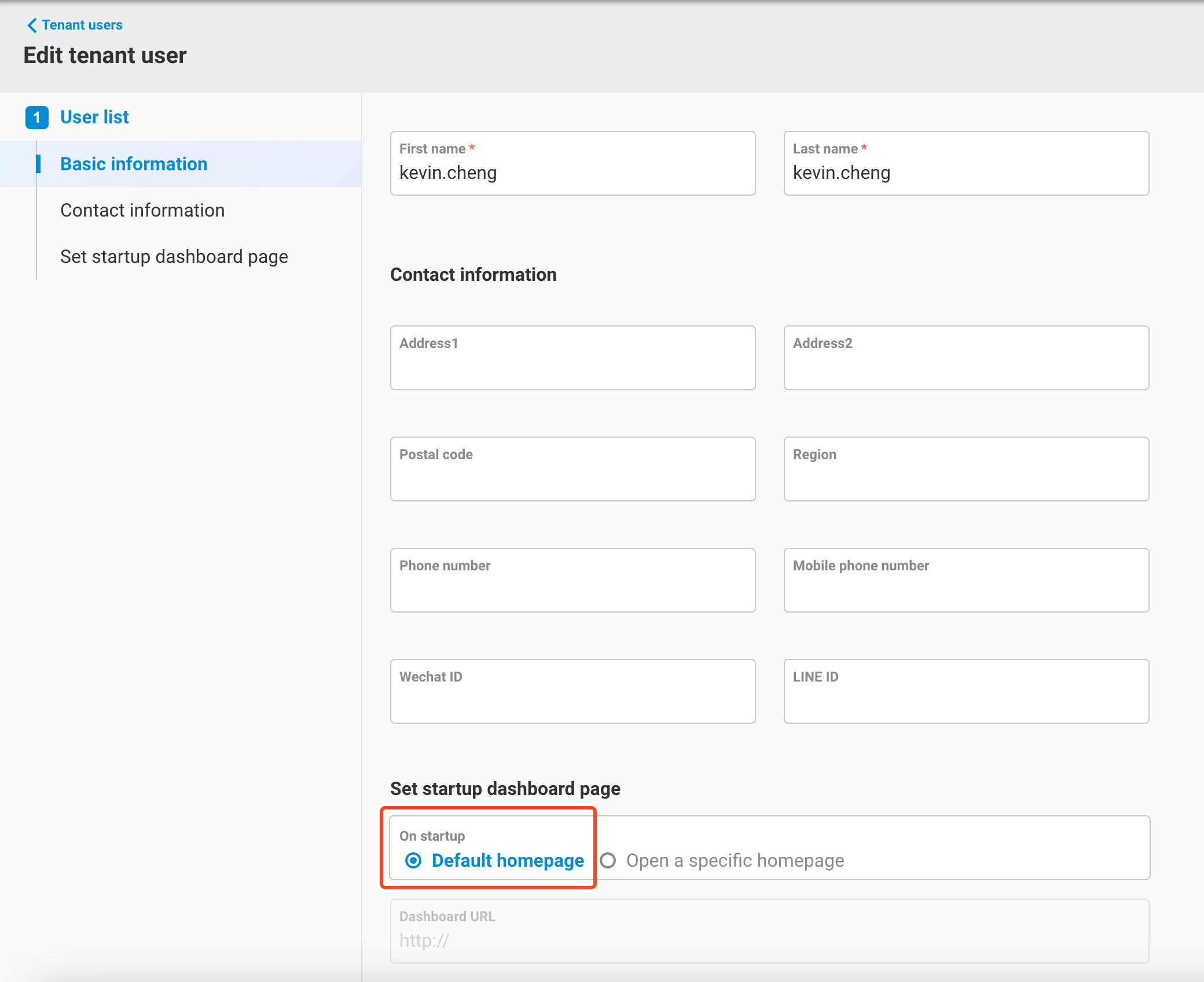

  3. In the user settings, find the "Set startup dashboard page" setting. By default, it is set to "Default Homepage," which refers to the Dashboard. login-dashboard-03-default-new.png

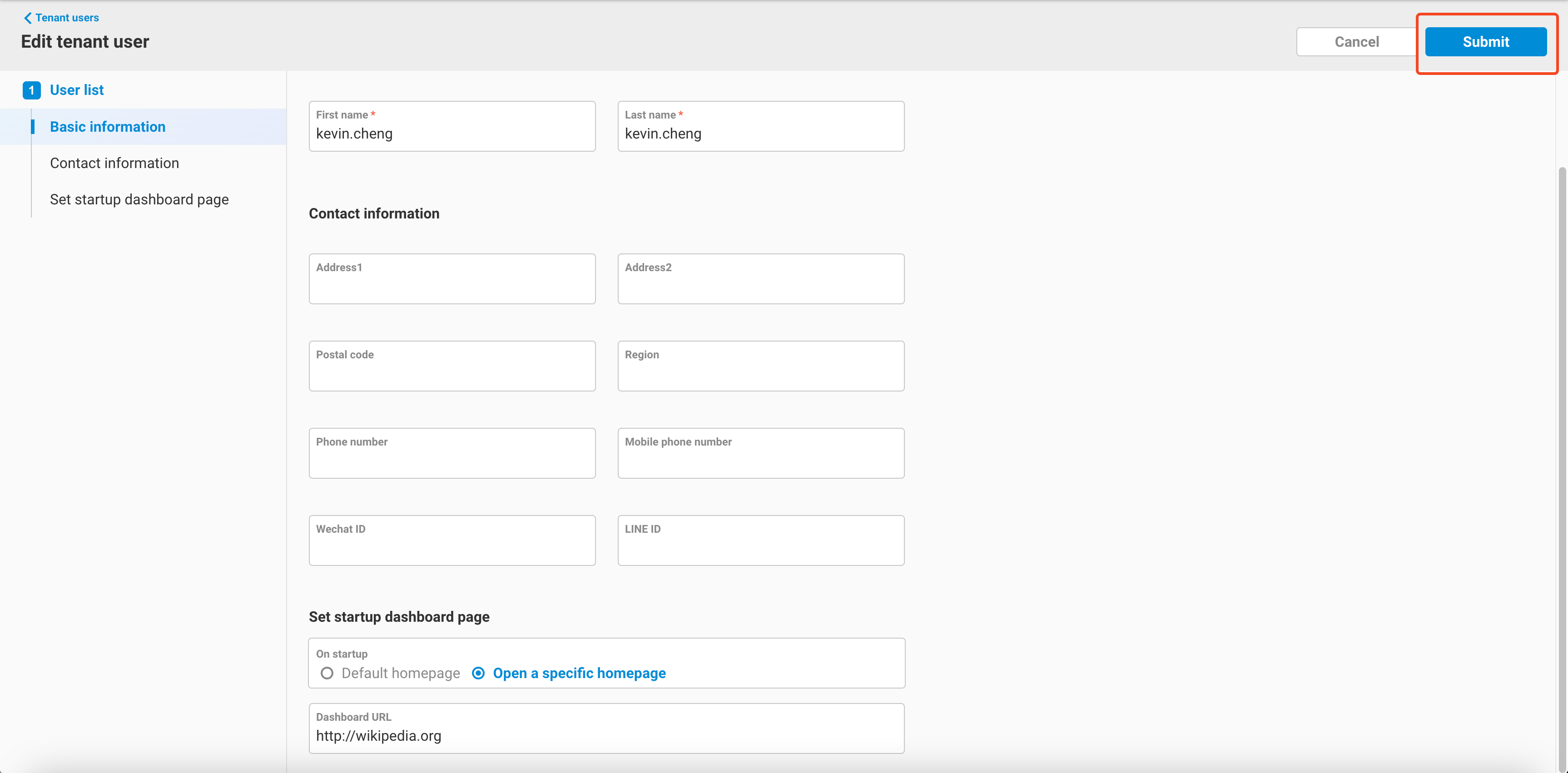

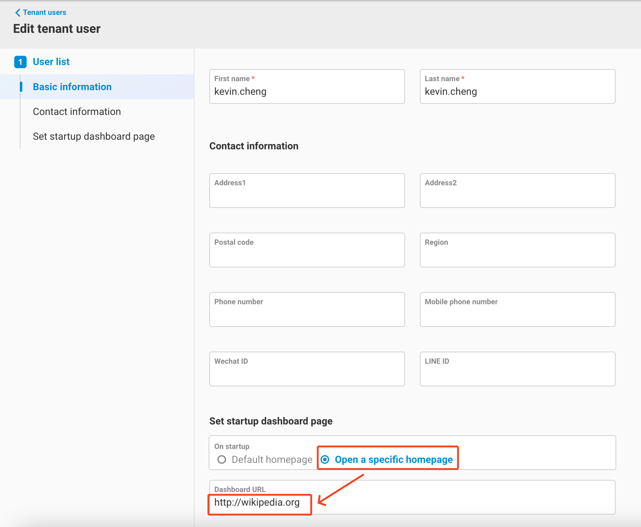

  4. Switch the setting to "Open a specific homepage" and enter the URL of the custom website in the Dashboard URL field. login-dashboard-04-custom-url-new.png

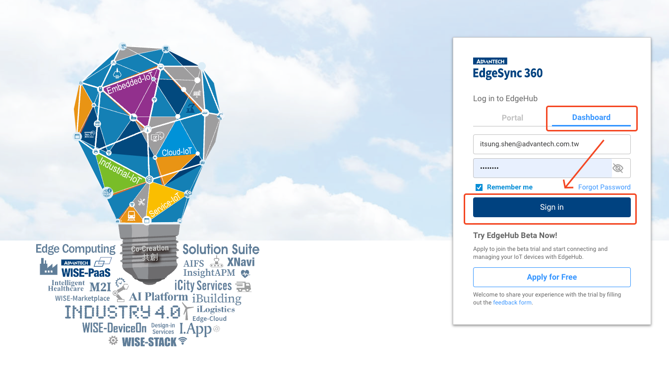

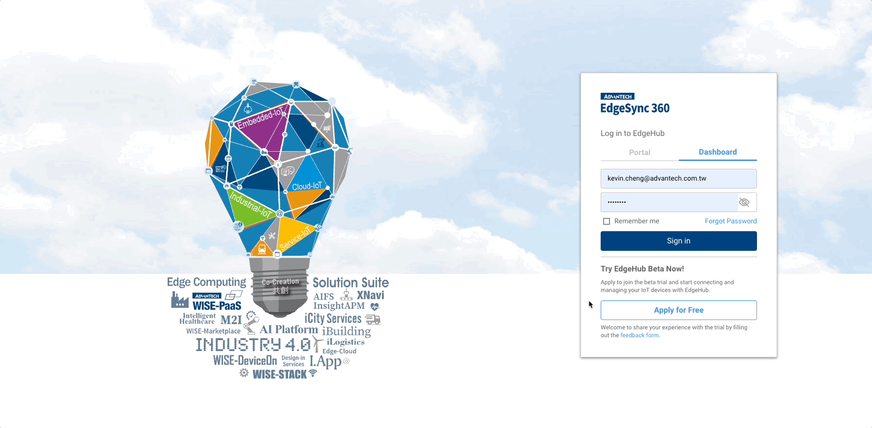

  6. Log out of the account and go back to the login interface. Select the "Dashboard" tab. login-dashboard-06-login-page-new.png
  7. Enter the username and password, then click "Sign in."

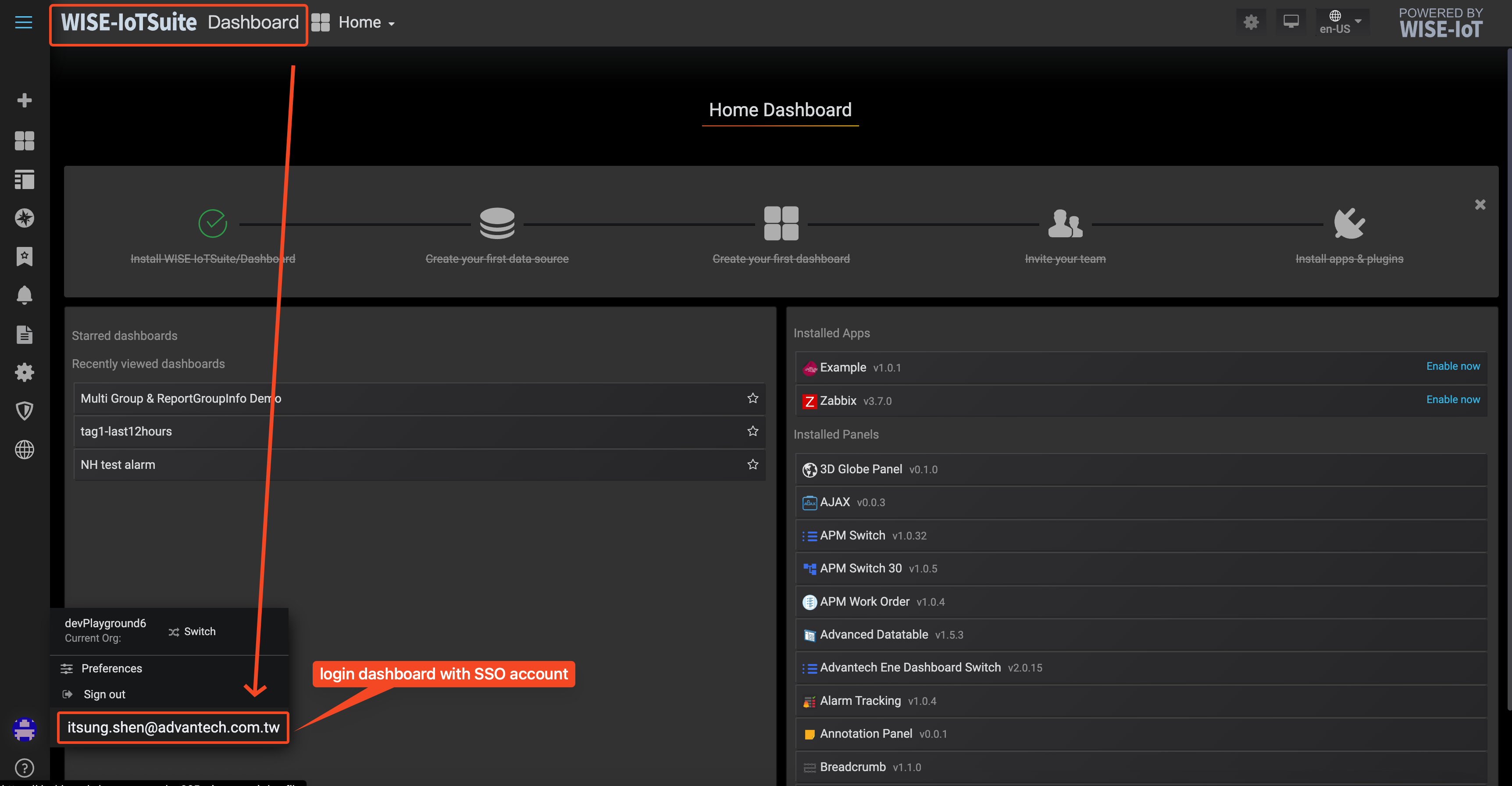

    • If this account has not changed the settings, it will redirect to the Dashboard, and you will see that you have logged in with the same account. login-dashboard-07-dashboard.png
    • If this account has a specific homepage set, it will redirect to that custom website. login-dashboard-08-redirect-wikipedia-new.gif
