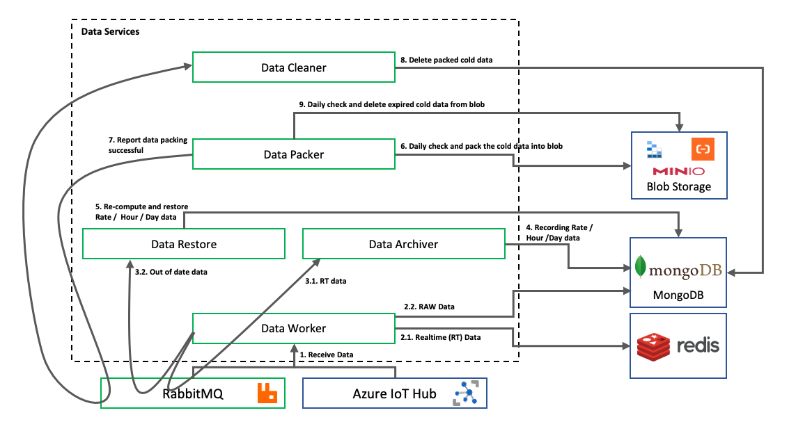

2. Data Retention Strategy
EdgeHub's data services comprise:
  • Data Worker
    • Processes raw data uploaded from edge devices to the Message broker (RabbitMQ / Azure IoT Hub)
    • Retains real-time data (Realtime(RT) data)
    • Retains raw historical data (RAW Data)
    • Notifies Data Archiver for historical data computation
    • Notifies Data Restore of out-of-date data (if any) for data recalculation
  • Data Archiver
    • Handles historical data computation for parameters and retains computation results at different time precisions
    • Retains Recording Rate data (Rate set in parameters)
    • Retains Hour data
    • Retains Day data
  • Data Restore
    • Receives notifications of out-of-date data and performs historical data recomputation
    • Computes Recording Rate data
    • Computes Hour data
    • Computes Day data
  • Data Packer
    • Regularly backs up cold data in MongoDB to Blob
    • Notifies Data Cleaner to delete backed-up data after completion
    • Periodically deletes cold data in Blob exceeding the retention limit
  • Data Cleaner
    • Receives deletion commands from Data Packer and deletes backed-up data from MongoDB
From the above description:
  • When data in MongoDB is retained for a certain period, it is identified as cold data, triggering the backup mechanism to move the data to Blob.
  • After the data migration is complete, MongoDB data is deleted.
  • When data in Blob exceeds the configured maximum retention date (refer to the Data Archiving section), it is removed from Blob.
