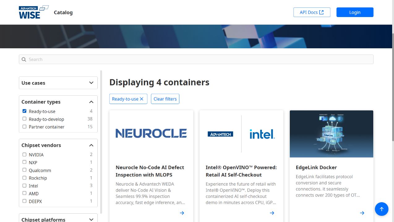

  1. Open Advantech Container Catalog.
  2. Under Container types, select Ready-to-use. Use Clear filters if you need to remove a previous selection.
  3. Use the search field, Use cases or hardware filters to narrow the results for your application and target device.
  4. Open Intel OpenVINO Powered: Retail AI Self-Checkout from the results.
ACC filtered by Ready-to-use, showing the selected filter and application cards including Intel OpenVINO Retail AI Self-Checkout.
Select Ready-to-use before choosing an application for direct deployment.
Check the result: The selected filter appears above the results, and the application's detail page provides Overview, Tags and Compatible hardware entries.

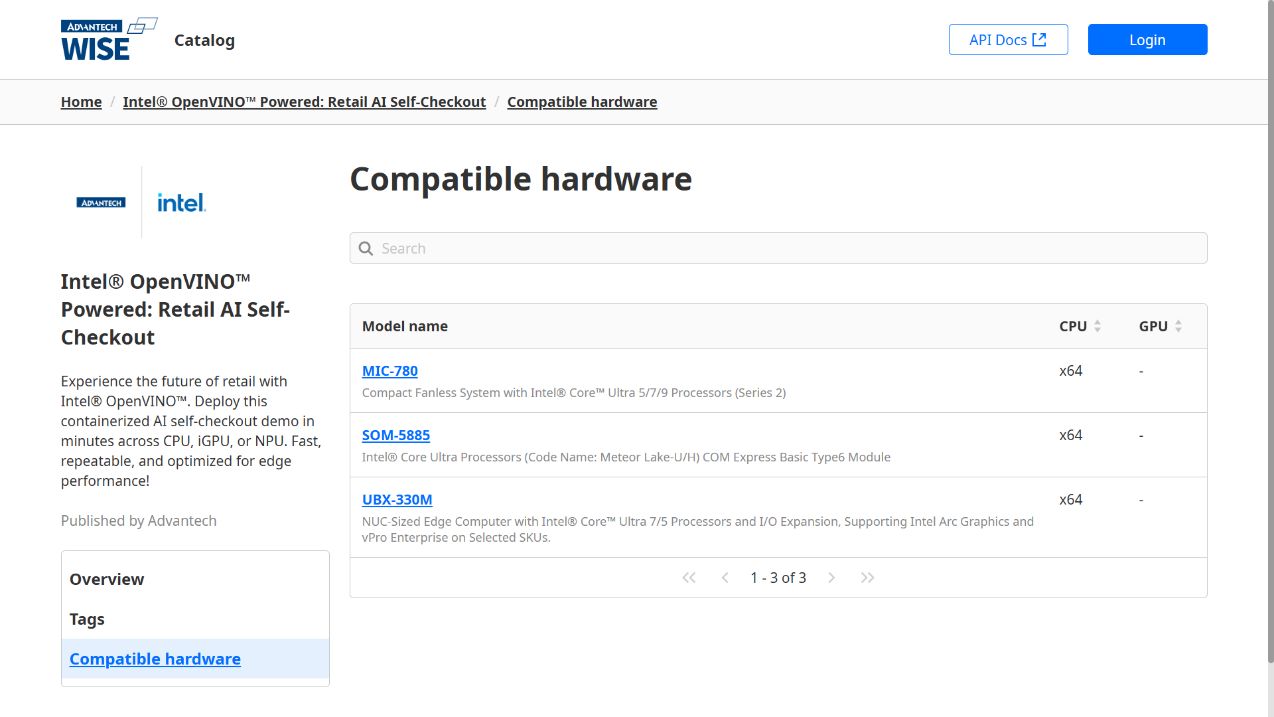

  1. Open Compatible hardware and check your target model. For this example, the list includes MIC-780, SOM-5885 and UBX-330M. Use the live listing when selecting hardware for a particular application version.

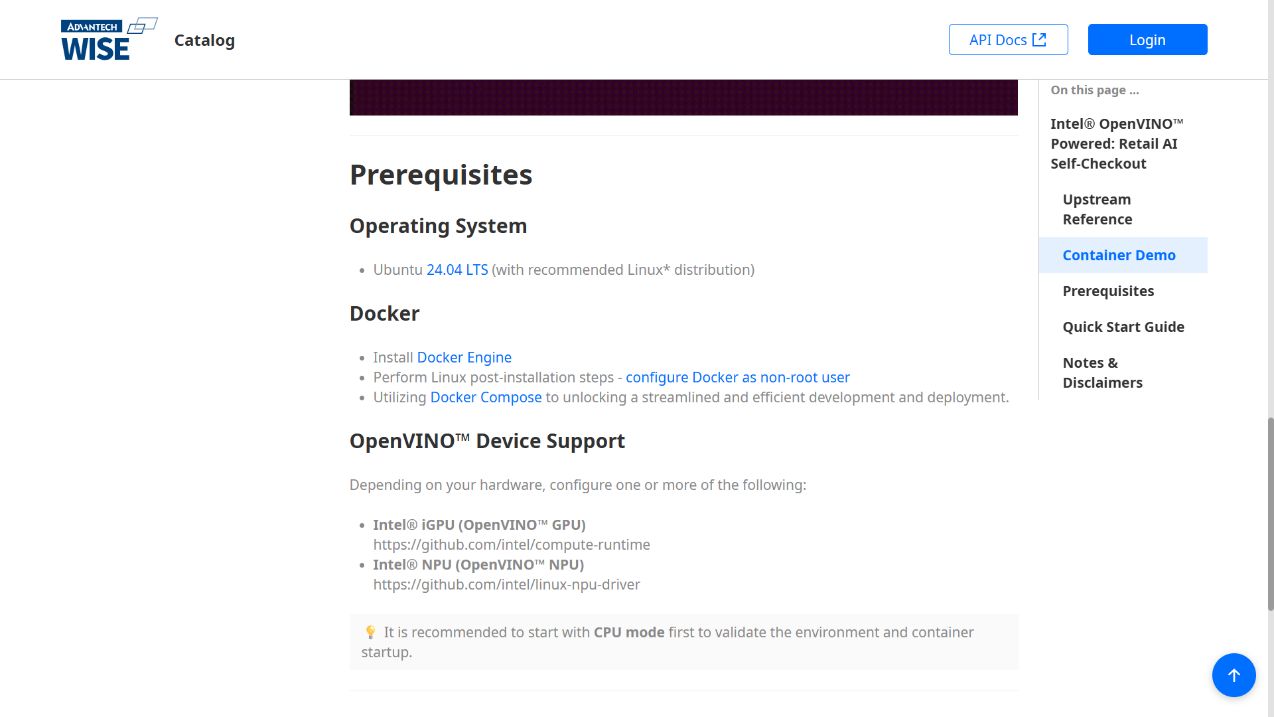

  2. Return to Overview and read Prerequisites.
  3. Compare the application requirements with the software and peripherals available on your target device.
Retail AI Self-Checkout Compatible hardware page listing MIC-780, SOM-5885 and UBX-330M with x64 CPU entries.
Check the selected application's hardware list rather than assuming compatibility from the chipset vendor alone.
The example's catalog page and repository describe these requirements:
RequirementWhat to prepare for this example
Host operating systemUbuntu 24.04 LTS.
Container toolsDocker Engine and Docker Compose. Git is used to retrieve the example files.
Inference deviceStart with CPU mode for initial validation. Intel iGPU or NPU operation requires suitable hardware and the corresponding host drivers.
DisplayA target-device desktop and X11 access for the application's preview window and interactive Region of Interest (ROI) selection.
Video inputPrepare a camera if you intend to use live video. The supplied startup script also supports automatic camera detection with a configured fallback video.
Retail AI Self-Checkout prerequisites showing Ubuntu 24.04, Docker, OpenVINO device support and the recommendation to begin with CPU mode.
Read the selected item's operating system, runtime and accelerator requirements before preparing deployment settings.

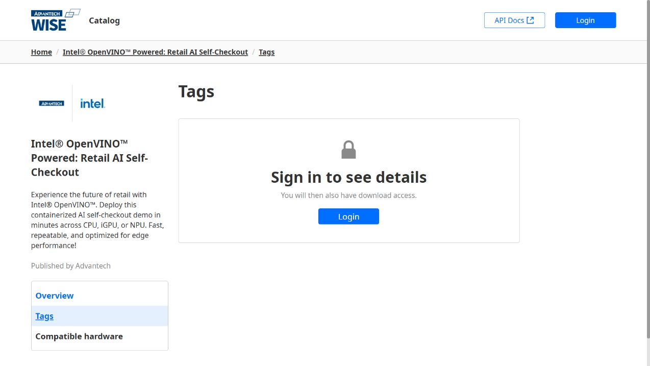

  1. Open Tags to review the application's version and download information. If the page displays Sign in to see details, select Login and sign in before continuing.
  2. Record the image name and version you intend to use, then compare them with the image reference in the repository's Compose file.
  3. Review its environment variables, host paths and device access before preparing the WEDA Stack.
Retail AI Self-Checkout Tags page displaying Sign in to see details and a Login button for version and download access.
The Tags page requires sign-in to display version and download details.

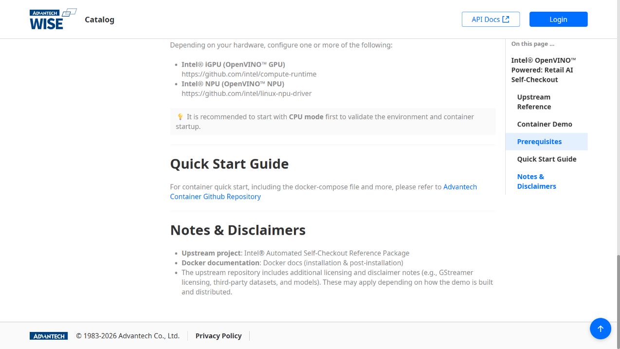

  1. On the catalog detail page, open Overview and find Quick Start Guide.
  2. Follow Advantech Container Github Repository to the Retail AI Self-Checkout repository.
Retail AI Self-Checkout Quick Start Guide with the Advantech Container Github Repository link.
The catalog's Quick Start Guide links to the application-specific repository and setup files.
