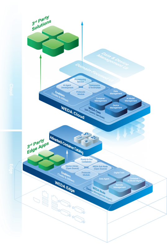

weda architecture
Architecture at a Glance
The diagram above shows the two layers and the traffic between them.
WEDA Core is the cloud-side coordination and management layer. It holds the intended configuration for every registered device, exposes REST APIs for the platform's capabilities, and orchestrates deployments across the devices you target.
WEDA Node is the device-side execution layer. It runs on the edge device, carries out what WEDA Core defines, and processes data locally.
The two layers exchange four things: configuration, management operations, device state, and telemetry. Edge applications run on WEDA Node as containers, and they reach peripheral hardware through WEDA SubNode and Device Library.
