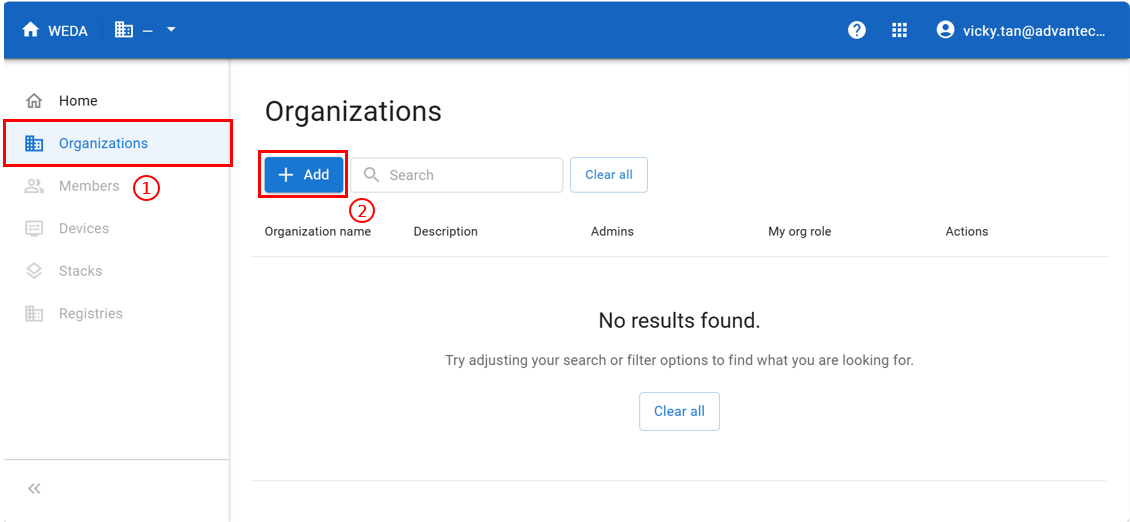

Create an Organization​
Organizations list
  1. Click Organizations in the left sidebar.
  2. Click the Add button to create a new organization.

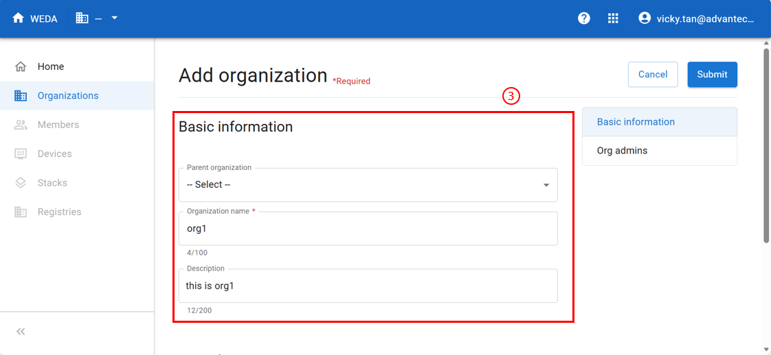

Add organization - Basic information
  1. Fill in the Basic information: optionally select a Parent organization, then enter the Organization name and Description.

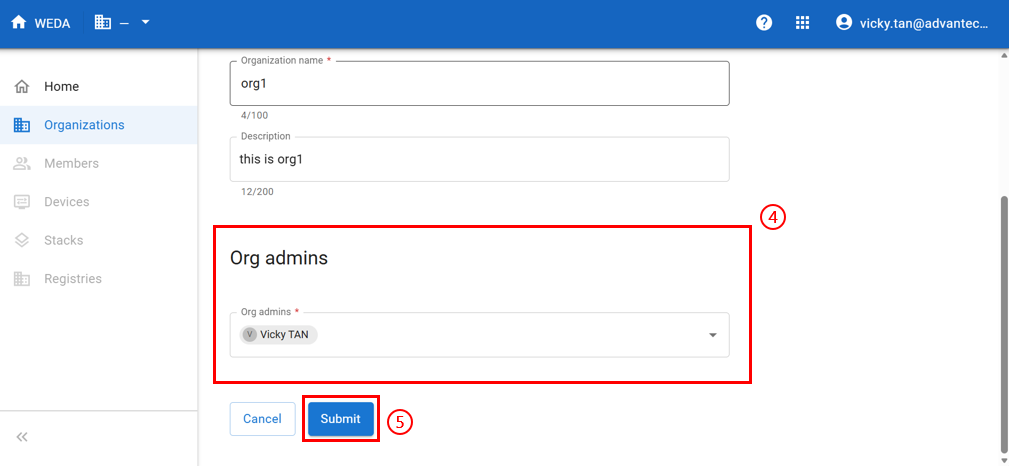

Add organization - Org admins
  1. Switch to the Org admins tab and assign at least one admin for the organization.

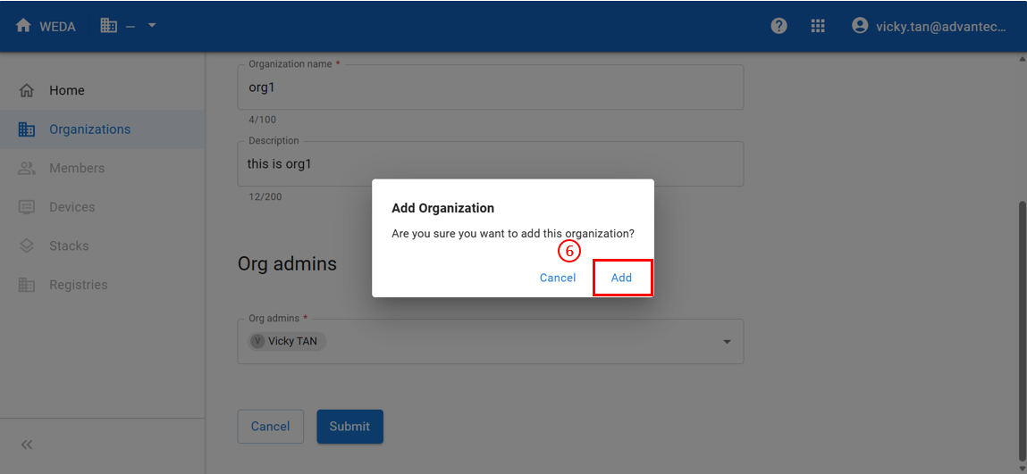

  2. Click Submit. A confirmation dialog appears.
Add organization - confirmation dialog
  1. Click Add to confirm.

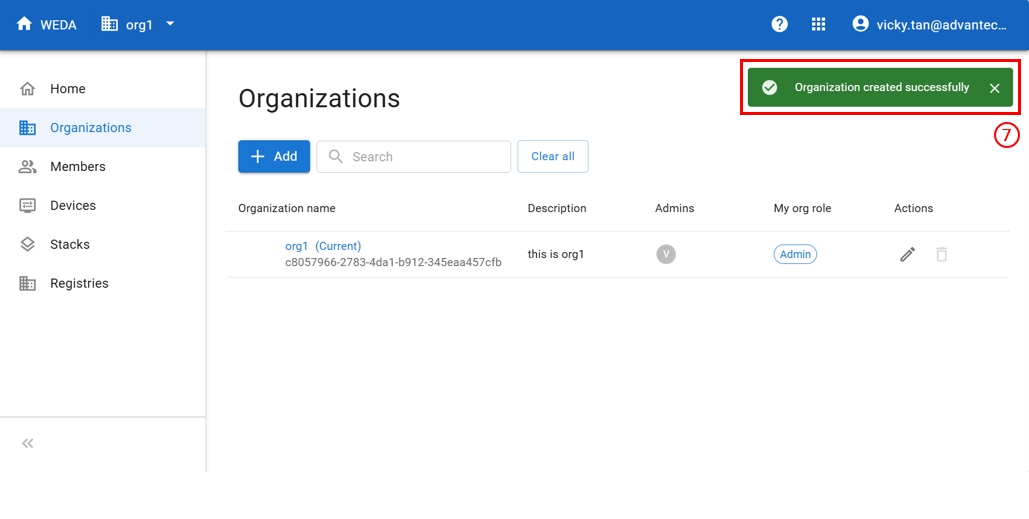

Organization created successfully
  1. The organization is created successfully. A success banner is shown, the new organization appears in the list, and it becomes the active organization (shown in the top-left switcher).

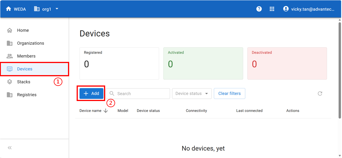

Devices list
  1. Click Devices in the left sidebar.
  2. Click the Add button.

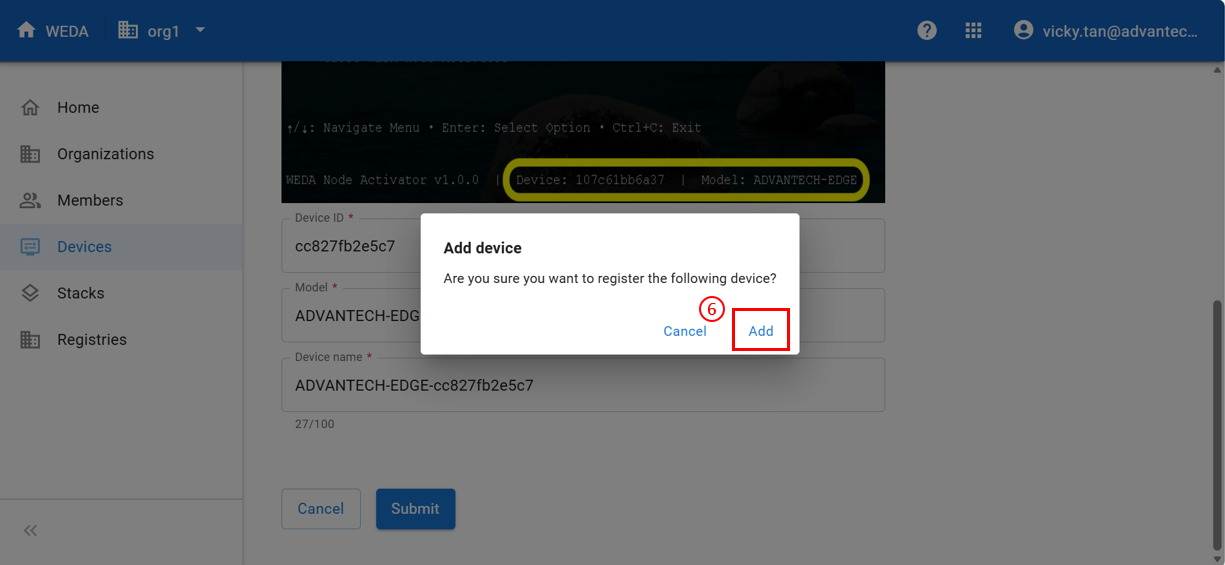

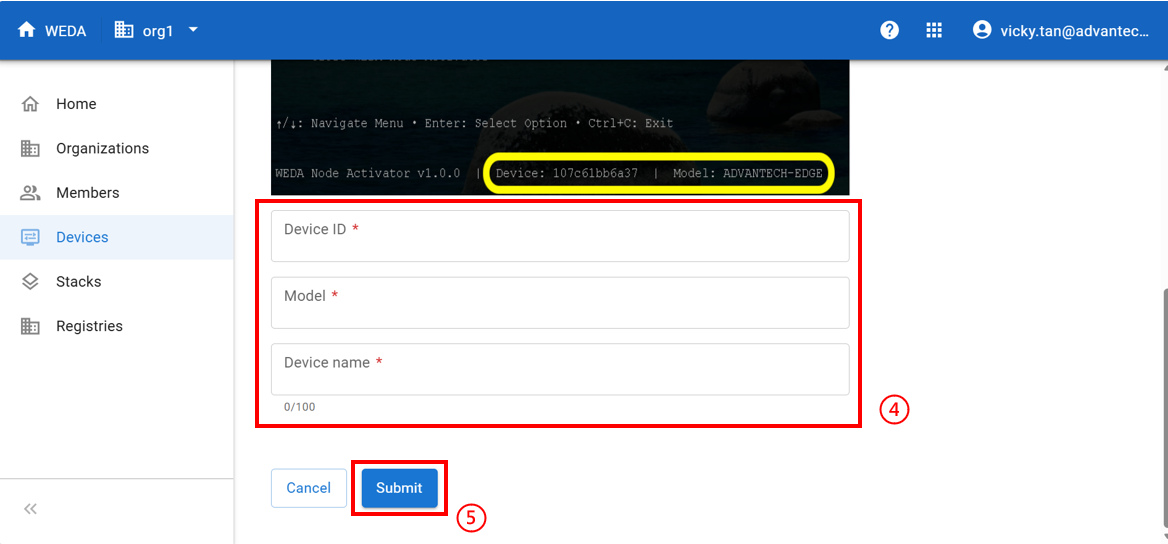

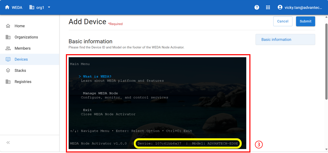

Add device - find Device ID and Model
  1. Find the Device ID and Model on the footer of the WEDA Node Activator.
Add device - fill in details
  1. Enter the Device ID, Model, and Device name.

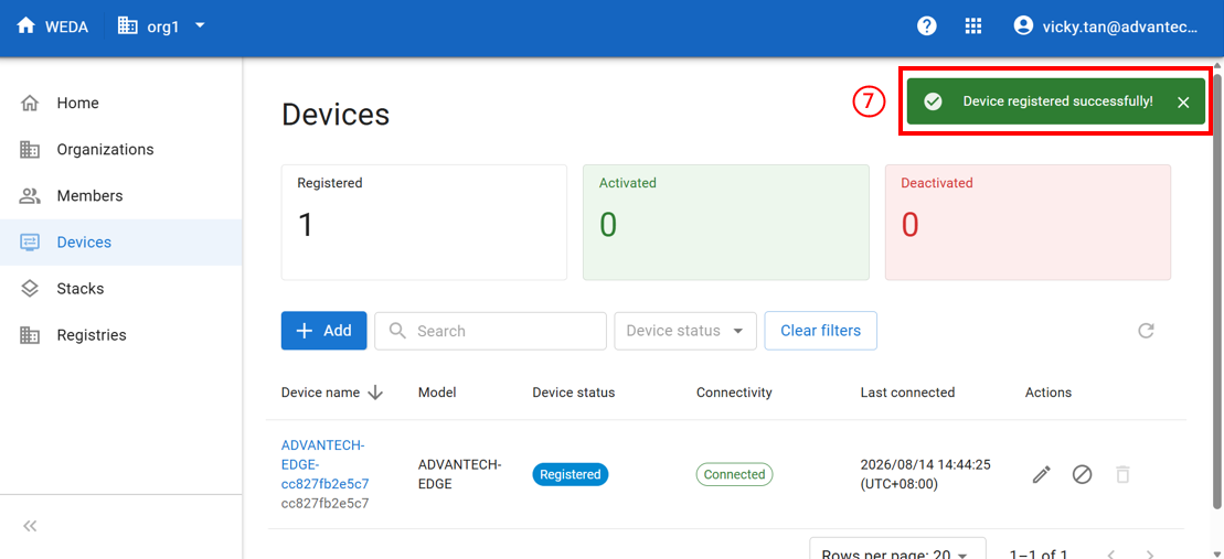

Add device - confirmation dialog
Device registered successfully
  1. Back on the Devices page, a success banner is shown and the device is listed with Registered status.

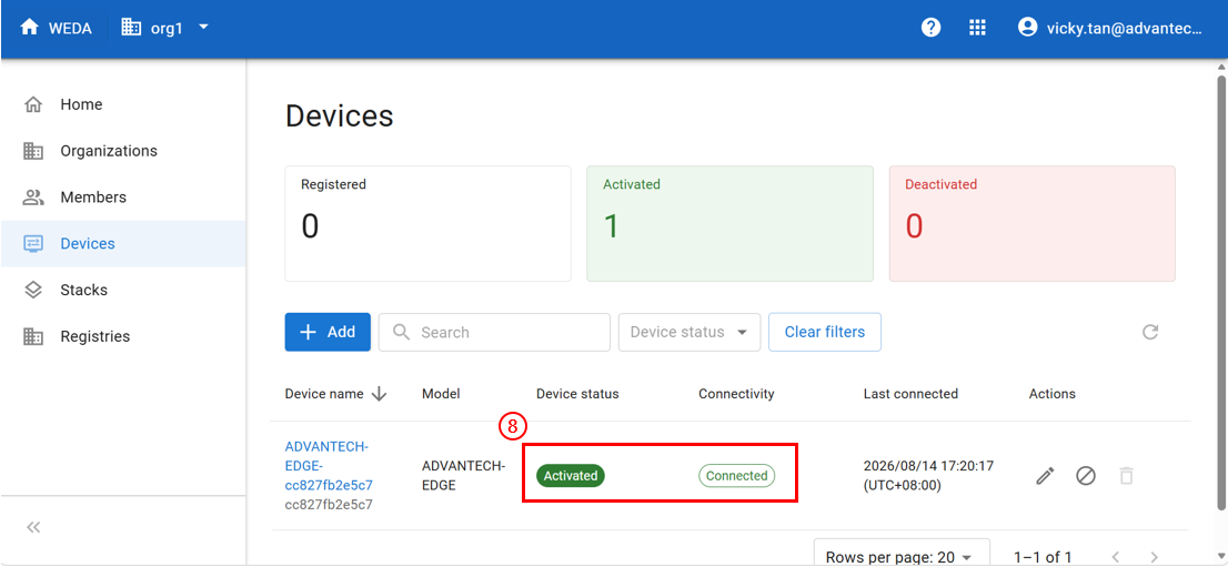

Device activated and connected
  1. Once WEDA Node connects on the physical device, the device status updates to Activated and Connected.

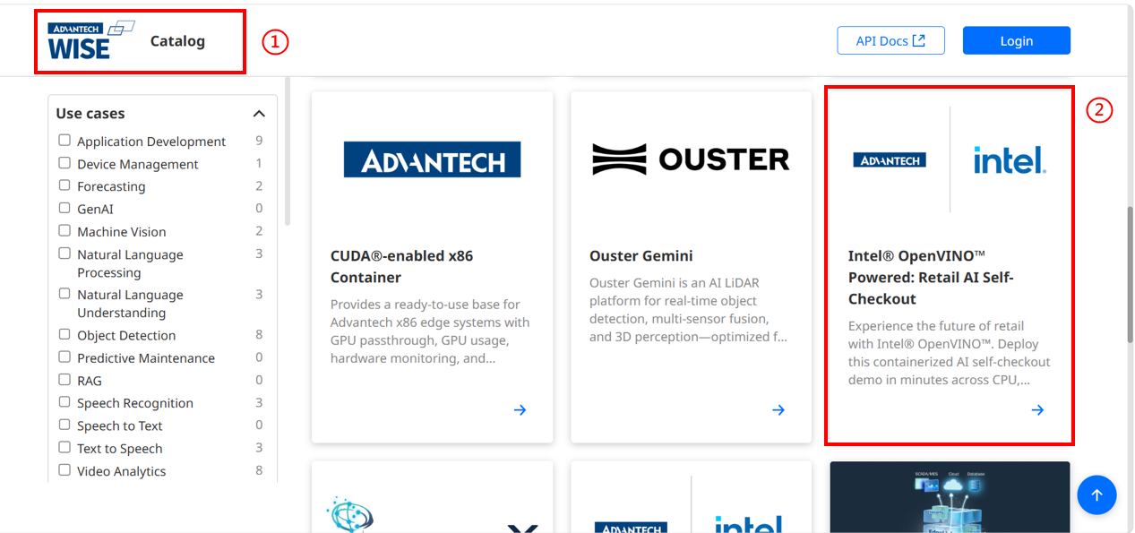

ACC catalog list
  1. Go to the Advantech Container Catalog (ACC).
  2. Choose a container.

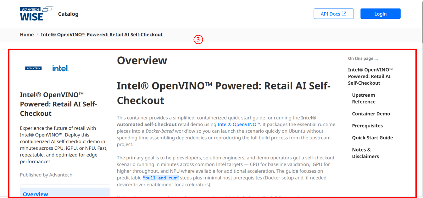

ACC container overview
  1. Open the container's detail page.

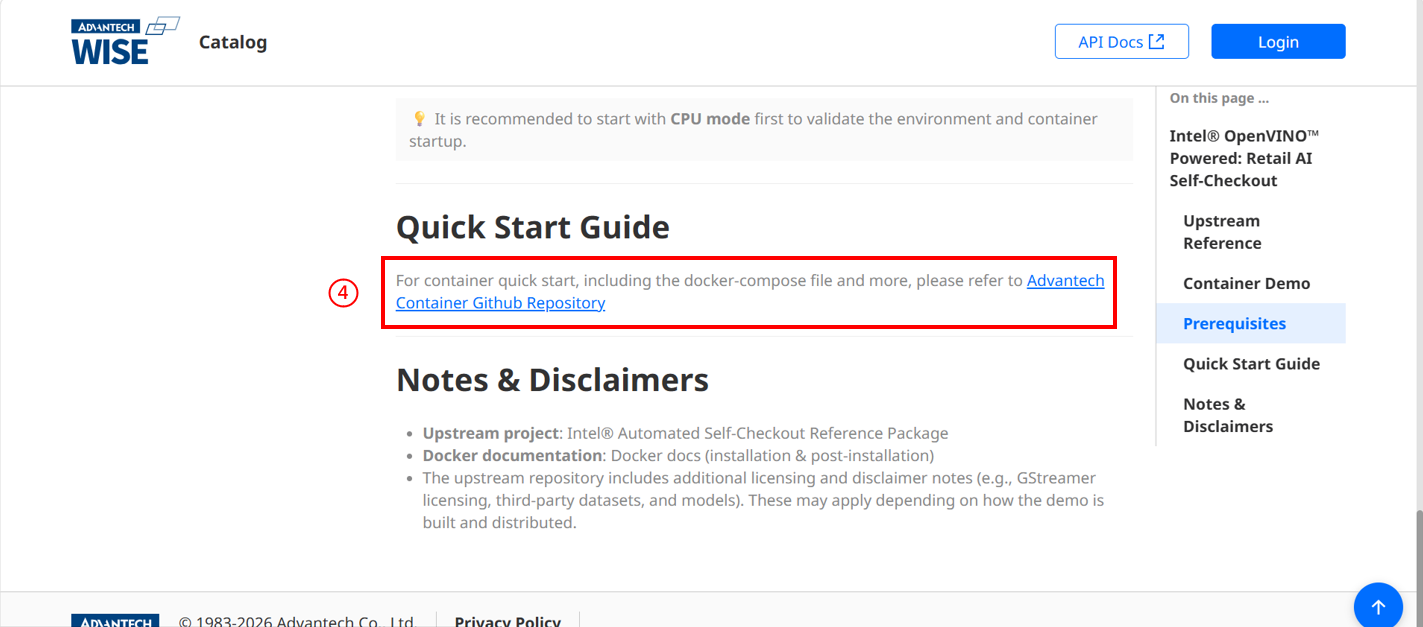

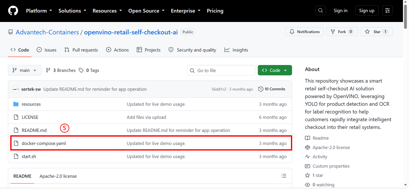

ACC quick start guide - GitHub link
  1. Click the Advantech Container Github Repository link in the Quick Start Guide section.
GitHub repository - docker-compose.yaml
  1. Download the docker-compose.yaml file for later use.

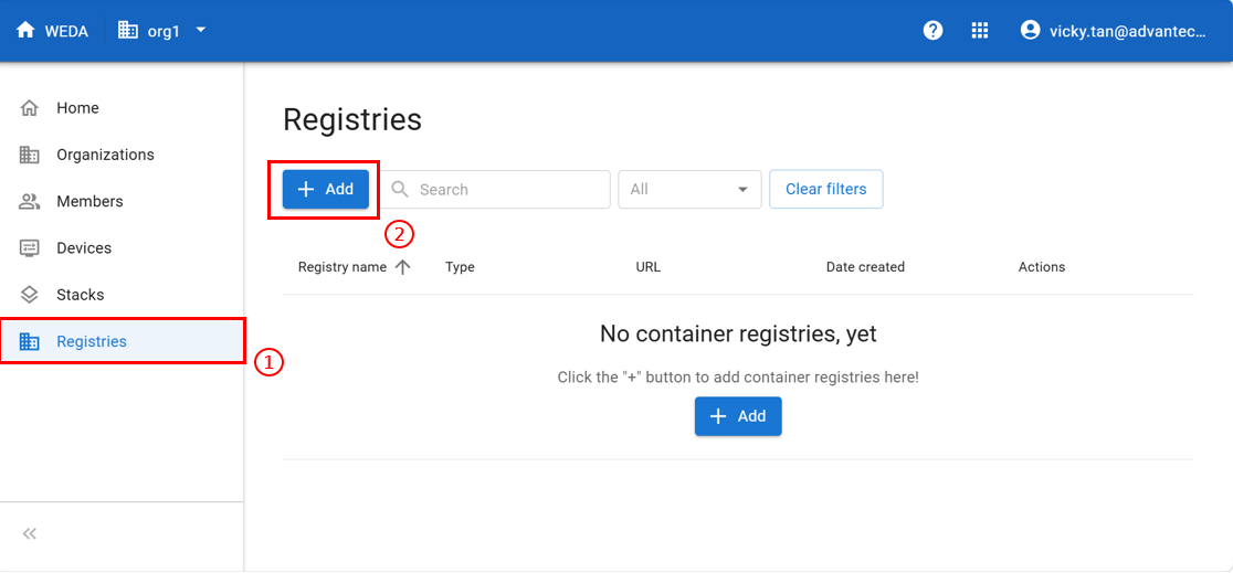

Registries list
  1. Click Registries in the left sidebar.

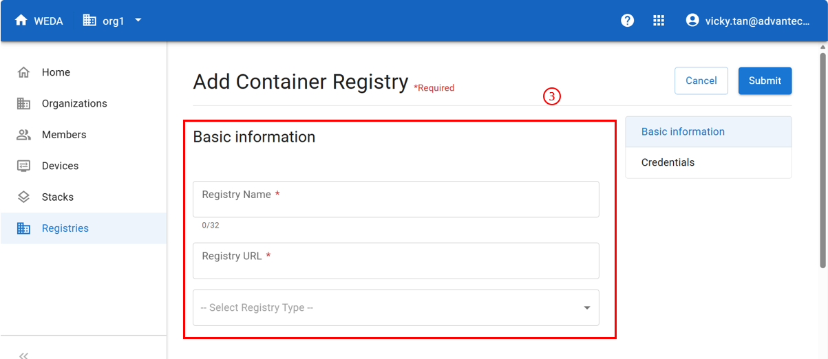

Add registry - Basic information
  1. Fill in the Basic information: Registry Name, Registry URL, and Registry Type.

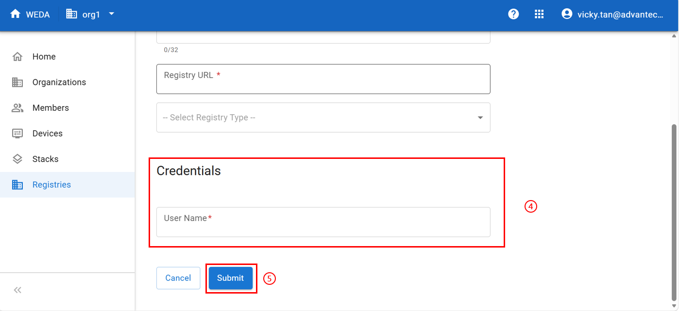

Add registry - Credentials
  1. Fill in the Credentials.

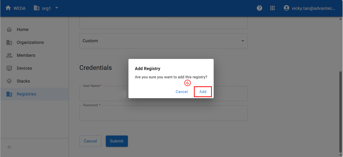

Add registry - confirmation dialog

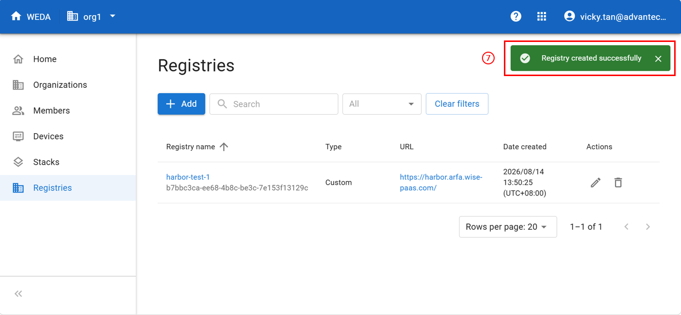

Registry created successfully
  1. Back on the Registries page, a success banner is shown and the new registry appears in the list.

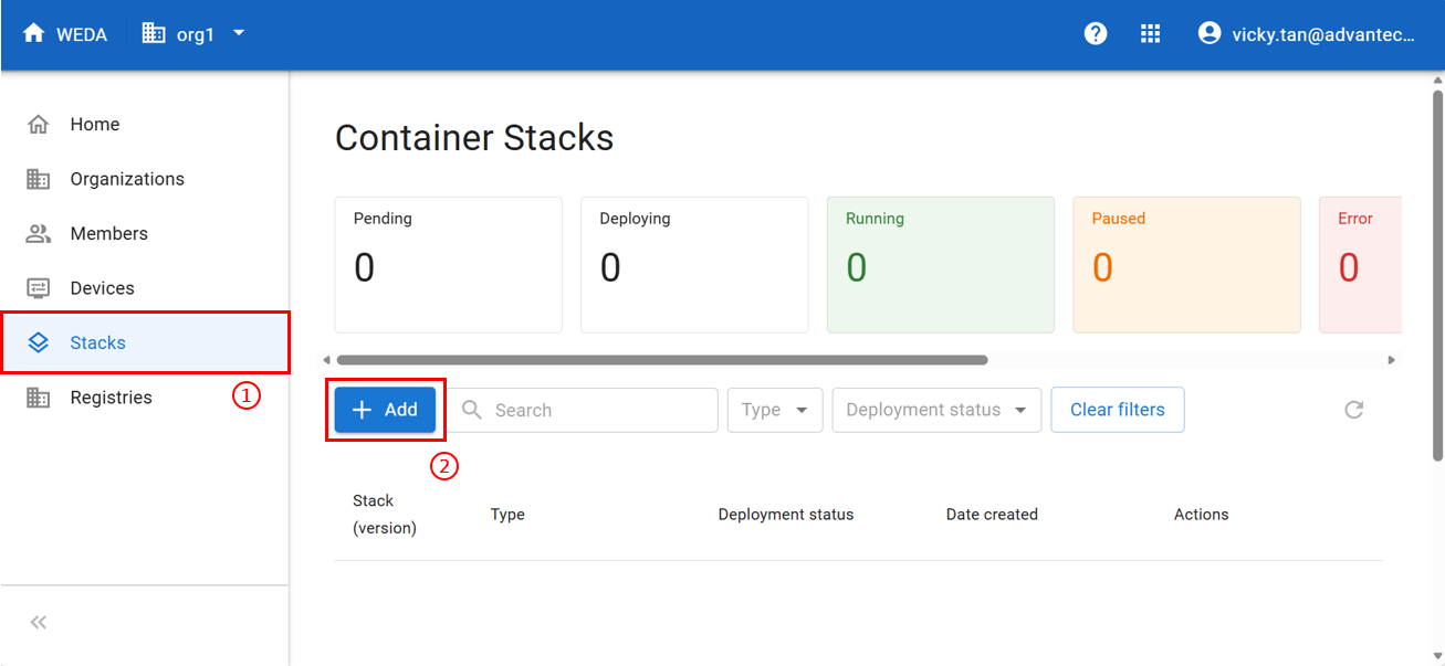

Create a Container Stack​
Container Stacks list
  1. Click Stacks in the left sidebar.

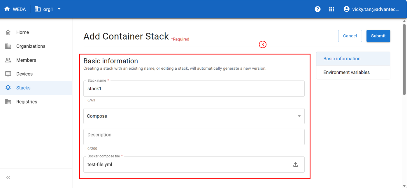

Add container stack - Basic information
  1. Fill in the Basic information: Stack name, type (e.g. Compose), optional Description, and upload the Docker compose file (the docker-compose.yaml downloaded from ACC).

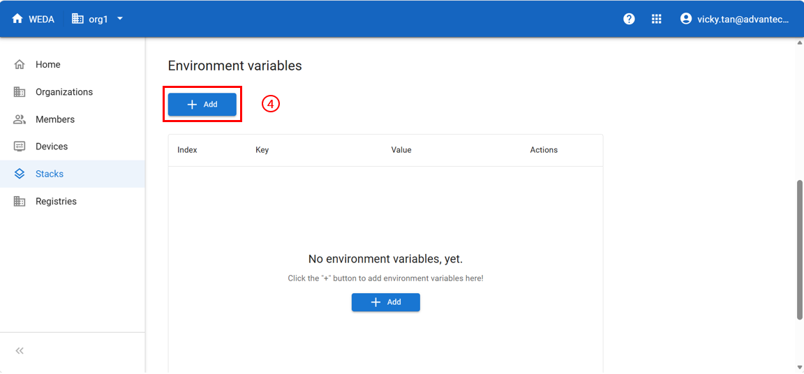

Add container stack - Environment variables

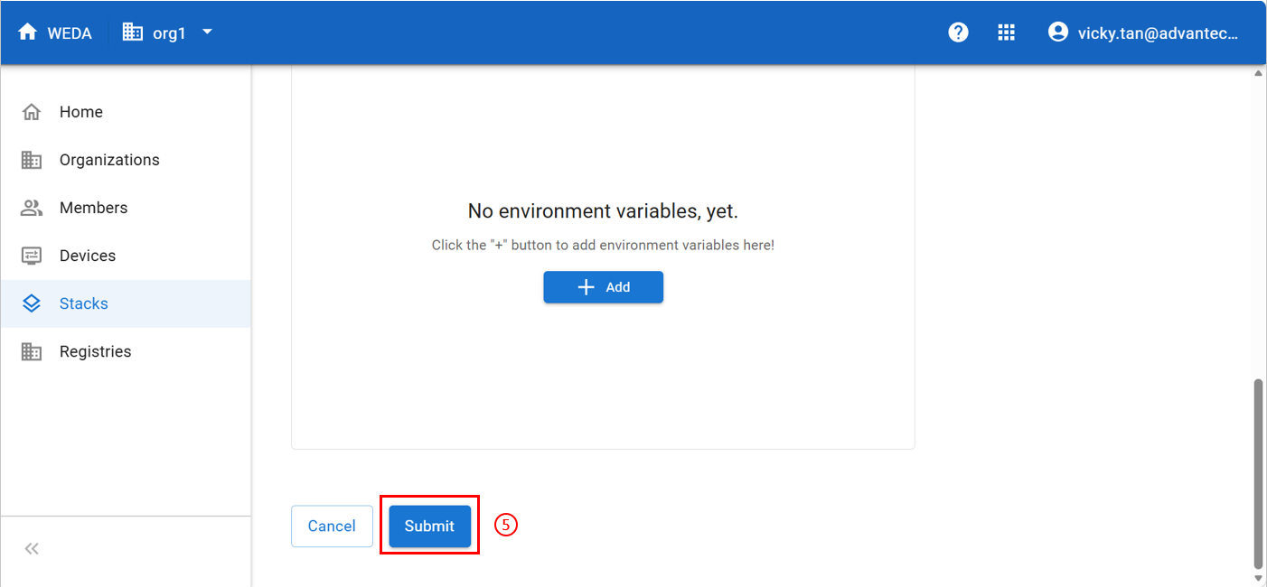

  1. Optionally add Environment variables.
Add container stack - Submit button
  1. Click Submit. A confirmation dialog appears.

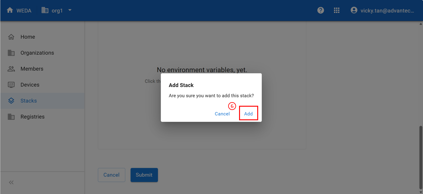

Add container stack - confirmation dialog

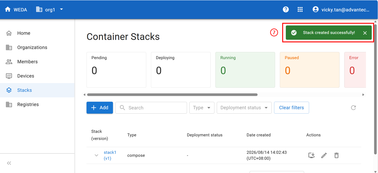

Container stack created successfully
  1. Back on the Container Stacks page, a success banner is shown and the new stack appears in the list.

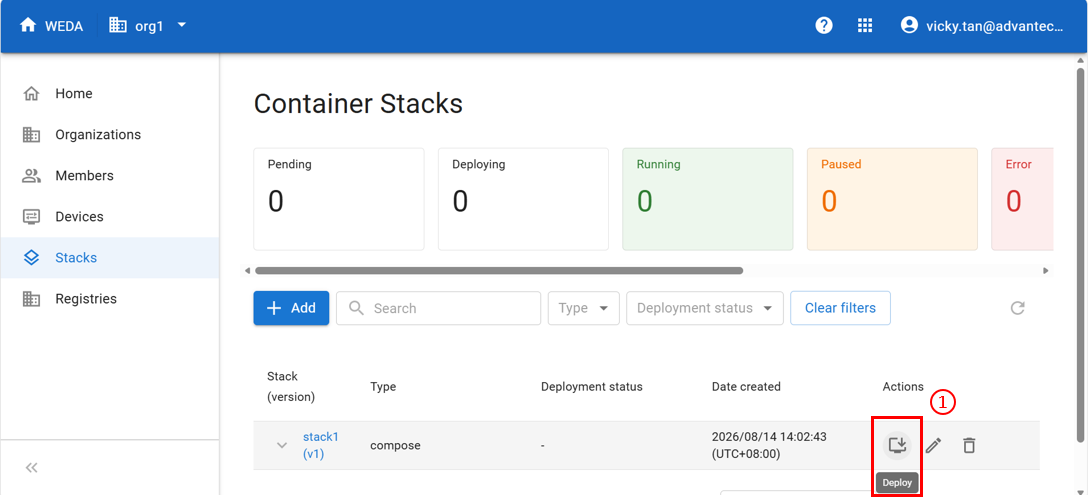

Container Stacks - Deploy button
  1. On the Container Stacks page, click the Deploy icon for the stack.

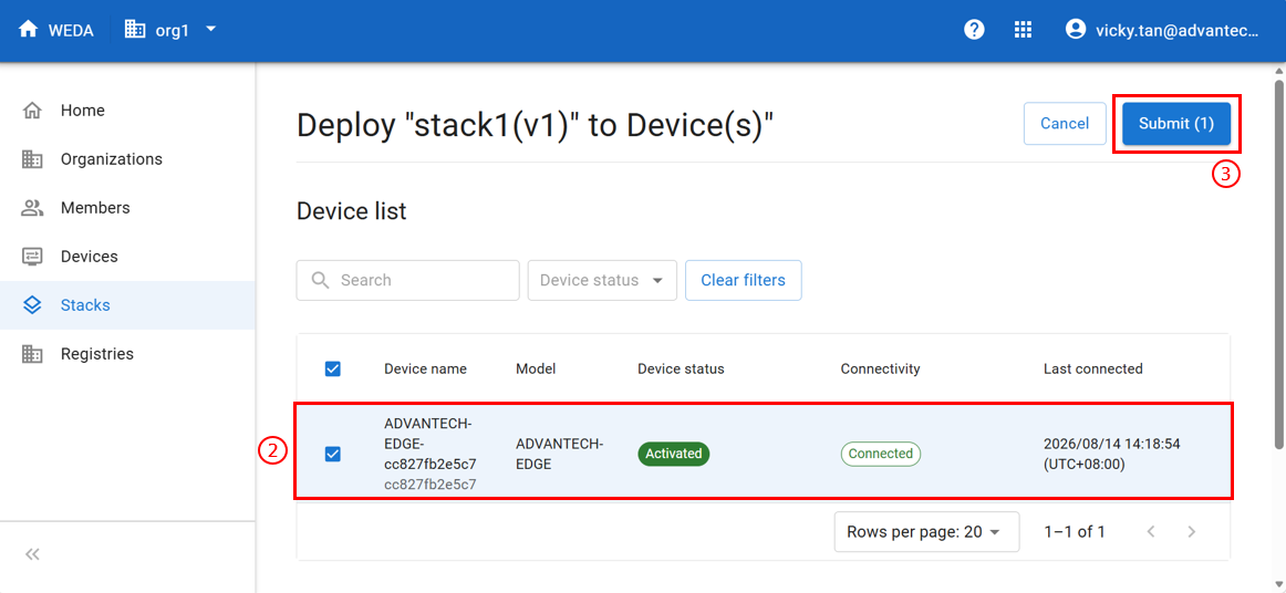

Deploy to Device(s) - device list
  1. Check the box next to the device(s) to deploy to.
  2. Click Submit.

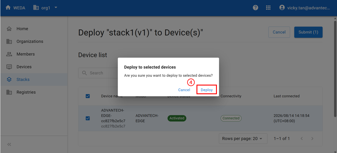

Deploy - confirmation dialog
  1. Click Deploy to confirm.

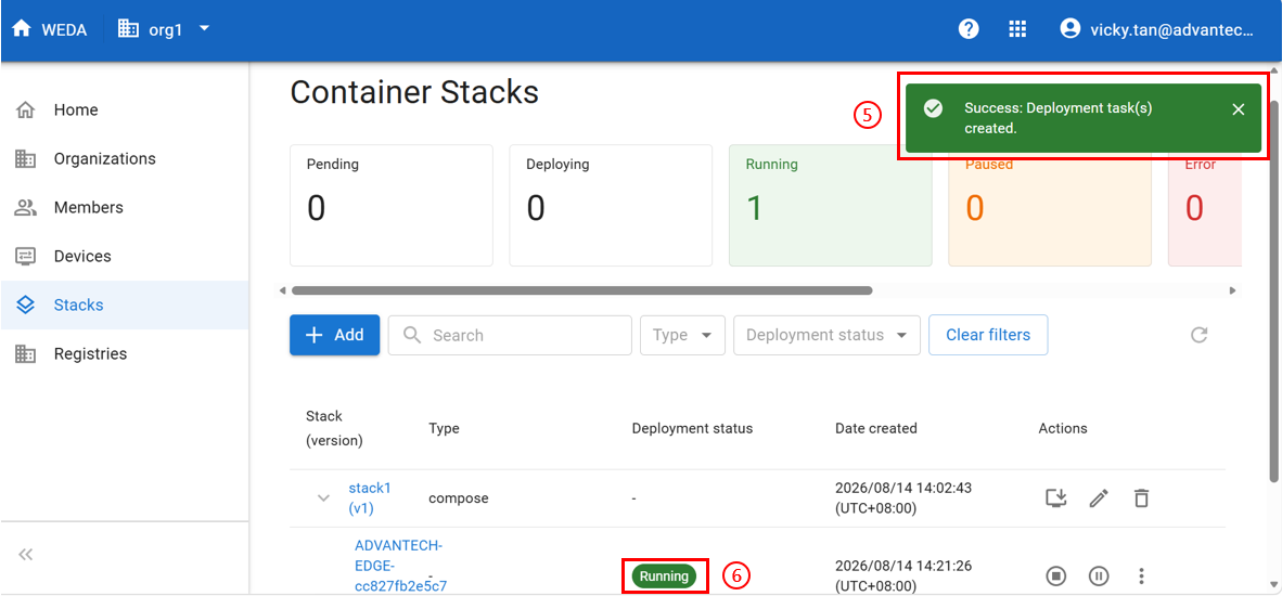

Deployment created - stack running
  1. Back on the Container Stacks page, a success banner is shown.
  2. Wait for the deployment status to reach Running.

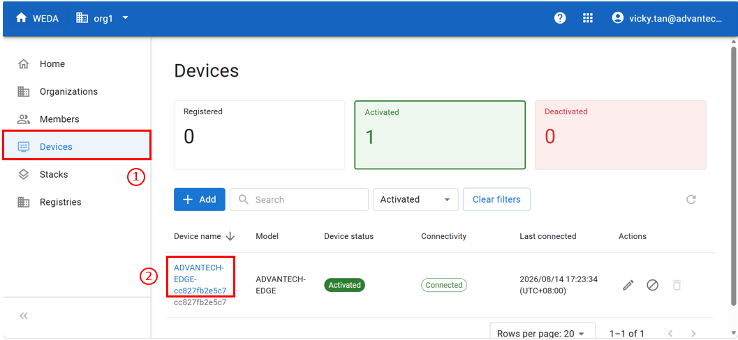

Devices list - select a device
  2. Click a device in the list.

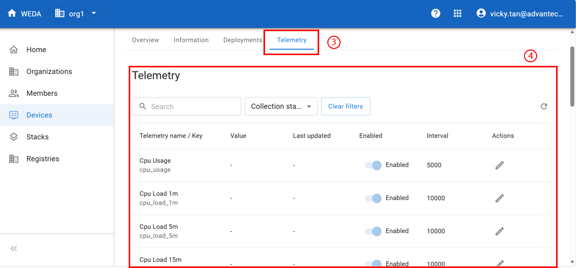

Device detail - Telemetry tab
  1. Click the Telemetry tab.
  2. View the latest value of each telemetry item.
