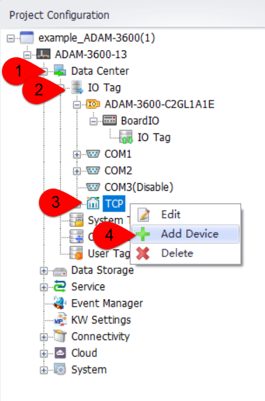

1.Add Device
  • DataCenter--->I/O Tag--->TCP--->Right Click:Add Device

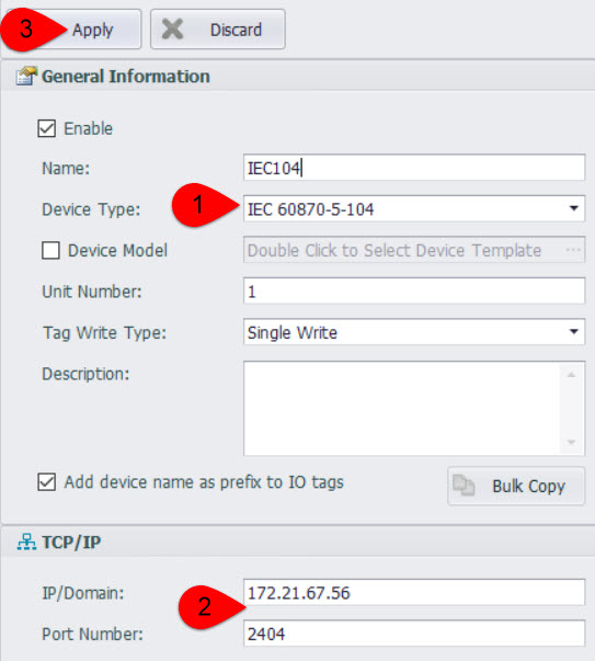

2.Configure the device
  • Select Device Type:IEC 60870-5-104--->Fill in the IEC104 server IP and port number: such as 172.21.67.56 and 2404--->click "Apply"
3.Add tag(s)
4.Download project,completed the quick configuration of IEC104.

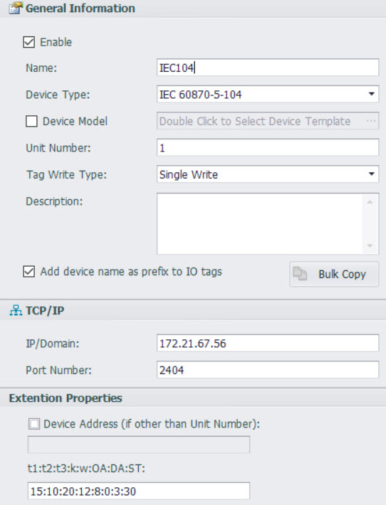

1.Detailed configuration interface instructions
  • Name: Fill in as desired.
  • Device Type: Select IEC 60870-5-104.
  • IP/Domain Name: The IP address of the IEC104 server.
  • Port Number: The port number of the IEC104 server.
  • t1:t2:t3:k:w:OA:DA:ST:
    • t1:1~255 seconds, Refer to the IEC104 protocol for specific requirements.
    • t2:1~600 seconds, Refer to the IEC104 protocol for specific requirements.
    • t3:1~600 seconds, Refer to the IEC104 protocol for specific requirements.
    • k: 1~32767, Refer to the IEC104 protocol for specific requirements.
    • w: 1~32767, Refer to the IEC104 protocol for specific requirements.
    • OA:Master Address,Refer to the IEC104 protocol for specific requirements.
    • DA:Slave public address.
    • ST:Scan time. 1 ~3000 seconds.
